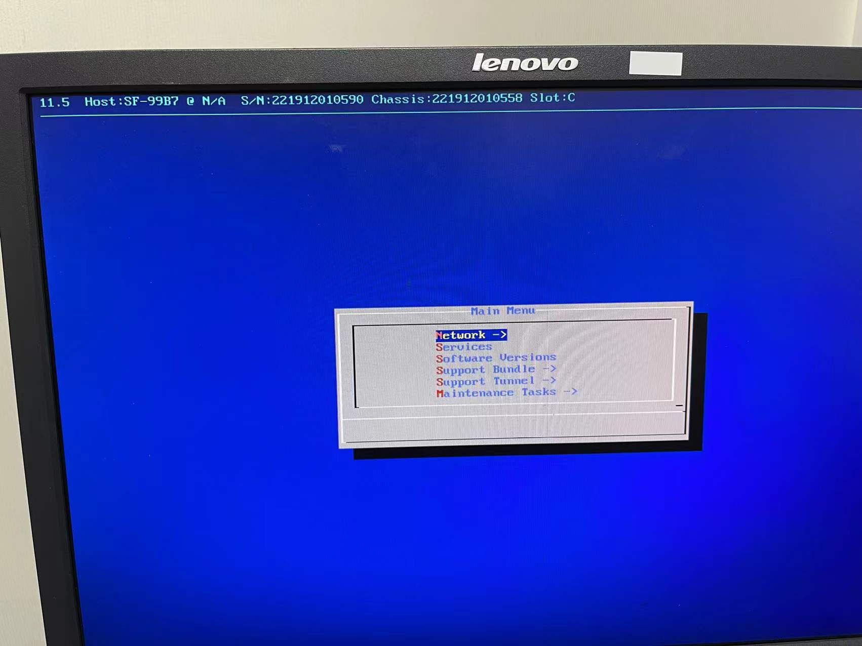

I have done this step on Storage Node as below ,
  1. Open the Terminal User Interface (TUI) console of the node via BMC/IPMI or iDRAC
  2. Select Maintenance Tasks
  3. Select Factory Reset Node
then after reset, I cannot enter to this GUI again.

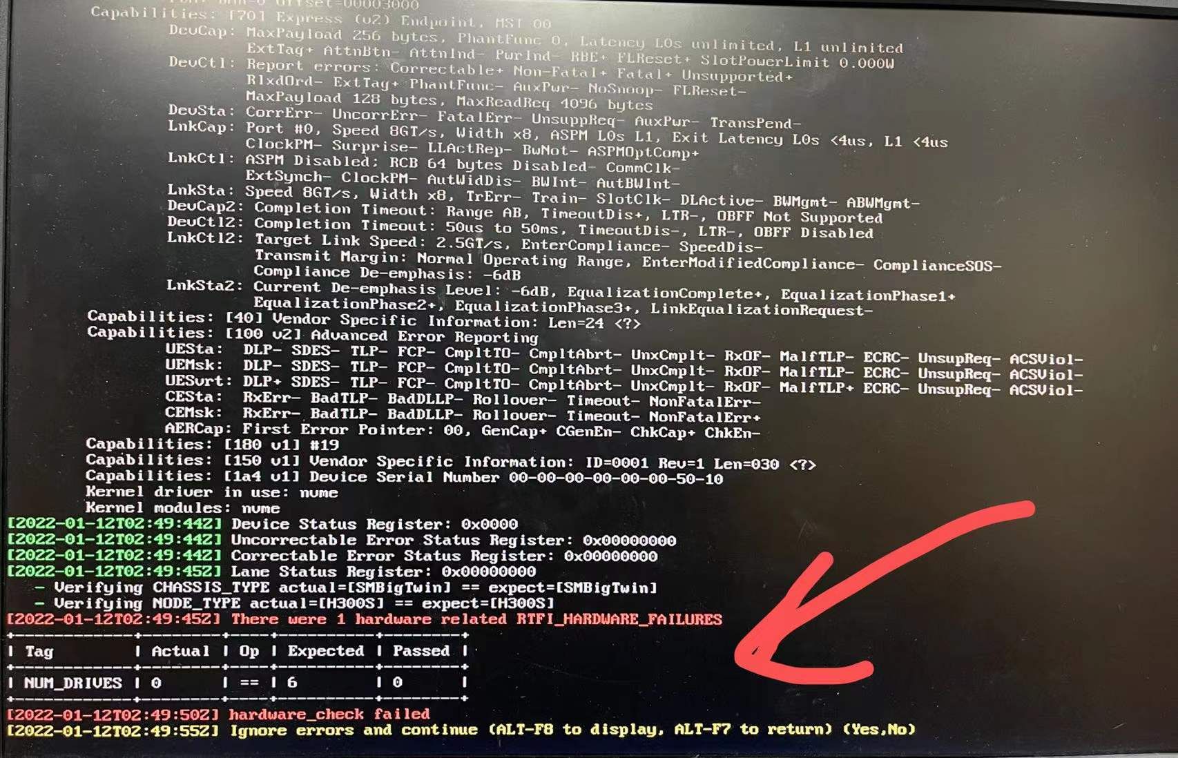

So, I tried to make usb with solidfire-rtfi-sodium-patch5-11.5.0.63.iso
then when it started installing,
  1. Yes’ to ‘Proceed’.
  2. ‘No’ to ‘Extensive Hardware Tests’.
until it ran to firmware checking, then it showed information as below
  1. 'There were 1 hardware related RTFI_HARDWARE_FAILURES'
  2. Tag 'NUM_DRIVES
  3. hardware_check failed
How can I fix it?

8 REPLIES 8

It would have helped if you mentioned what was wrong with the node before you decided to reimage the node.
Casual search engine check for `RTFI_HARDWARE_FAILURES` shows several KB articles, one of them is
https://kb.netapp.com/Advice_and_Troubleshooting/Hybrid_Cloud_Infrastructure/H_Series/Hardware_check_failed_with_CPU_Intel_Xeon_Gold_5120T_on_H610S
I'm not logged in so please check if this or other KB articles help you.
This isn't a common problem so maybe reach out to Support to eliminate guesswork.

In my situation like this
tagActualOpExpectedPassed
NUM_DRIVES0=60
So, do you have any idea or sugestion that I can try it?

elementx
9,289 Views
I'd say contact support.
It's unusual to see none of the drives were detected. If one failed, that'd be possible. It doesn't look possible that 6 failed, but I don't know how to solve this. I haven't encountered that situation yet.

NetApp_AU
9,032 Views
I am not sure if you got an answer from Support yet, but here is what I am seeing from your post.
The error message is saying that the RTFI process sees zero drives installed while six is expected. This is odd because you are imaging a H410C compute node which does not utilize drives like the storage nodes do.
I looked at the filename, solidfire-rtfi-sodium-patch5-11.5.0.63.iso, and this is the element RTFI image for the storage nodes, not compute nodes. That is why the process is checking for drives.
For comparison, an example of a compute node RTFI filename would be solidfire-compute-sodium-patch5-11.5.0.63.iso.
Can you confirm if you are trying to image a H410C compute node or a H410S storage node?

elementx
9,030 Views
That's an interesting observation.
The RTFI screenshot shows `actual=[H300S] == expect=[H300S]` so even if the image was wrong RTFI probably shouldn't reach that conclusion. It could be that the blades were shuffled around and now this blade's disk slots are empty.
NetApp_AU
9,029 Views
I think the RTFI process did not throw an error about the model number because the H410C compute node has very similar hardware to an H410S.
The H410S storage nodes are the exact same as the H300S, H500S and H700S storage nodes, just with a revised model number. See below.
H410S-11110 (H300S)
H410S-21110 (H500S)
H410S-31110 (H700S)
My theory is that we have an H410C compute node, but we are trying to install an H410S/H300S RTFI image on it. The process does a node model check, sees enough of the server components to match an H410S which the process is programmed for, and continues on with the checks until it hits the drive count check which stops it.
If my theory is correct, I agree that the RTFI process should include a compute vs storage node check specifically.
Team NetApp
elementx
9,028 Views
I agree with that, but I also think they may have a "personality" profile stored in CMOS or elsewhere. One useful feature of not continuing unless the personality says "Storage Node" is that accidental RTFI with Compute ISO wouldn't wipe a Storage Node's OS.
We'll see if the OP clarifies.
