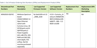

I'll let someone from Support answer that, but for Mellanox you can find EOS and EOL (support) info at https://network.nvidia.com/support/eol/ (once a product gets EOS'd, then it is added to this Excel file where you can look up EOS announcement (PDF link in Excel) and see which is the latest version of ONYX supported for it). But you can't find much in that Excel if the product hasn't been End-of-Sale'd yet. And NetApp may add other conditions and narrow the scope of which versions should be used in a NetApp HCI environment, so I won't try to give an answer.

Thanks for your info. I also review https://network.nvidia.com/support/eol/ before open post because I cannot found the answer.
If software image version have end of support date, we need this information notice customer must upgrade if the version reach end of support.
