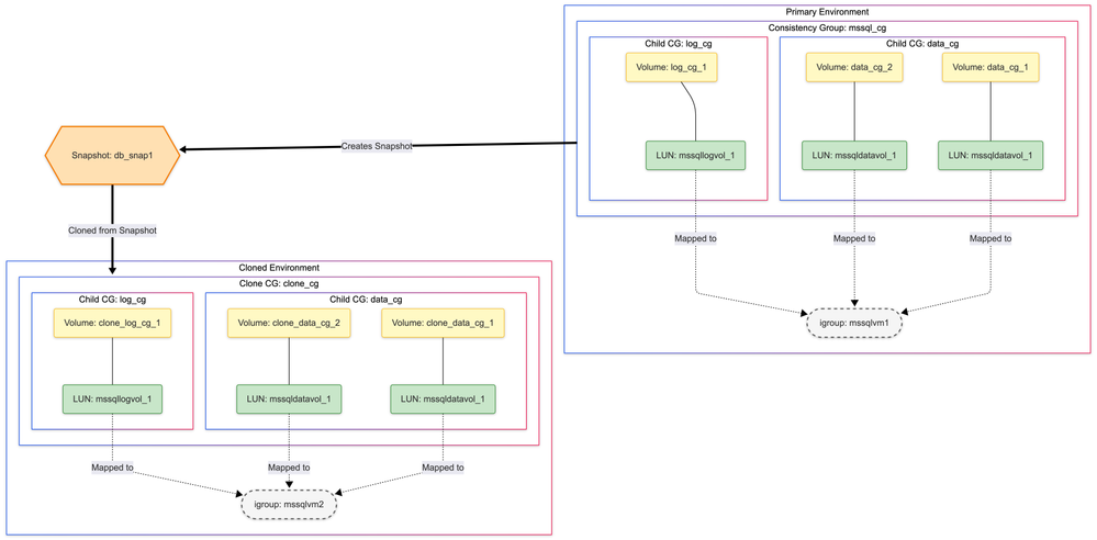

Architecture at a glance
The parent CG  (mssql_cg) groups child CGs for data and logs. Production LUNs are presented to mssqlvm1.  A CG snapshot captures the database consistently, and a CG clone (clonecg) can be mapped to mssqlvm2 for isolated testing or refresh.

  gcnv-bc2553acb2200f4-svm-01 /vol/data_cg_2/mssqldatavol_1  mssqlvm1  1  iscsi
  gcnv-bc2553acb2200f4-svm-01 /vol/log_cg_1/mssqllogvol_1  mssqlvm1  2  iscsi
  6 entries were displayed.
[demo@demovm]:~$ gcloud netapp storage-pools execute ontapmodepool --location=us-central1-a "lun show -fields size,size-used"
output: |+
  vserver                     path                                  size size-used
  gcnv-bc2553acb2200f4-svm-01 /vol/clonecg_data_cg_1/mssqldatavol_1 50GB 20.16GB
  gcnv-bc2553acb2200f4-svm-01 /vol/clonecg_data_cg_2/mssqldatavol_1 50GB 20.16GB
  gcnv-bc2553acb2200f4-svm-01 /vol/clonecg_log_cg_1/mssqllogvol_1   20GB 5.07GB
  gcnv-bc2553acb2200f4-svm-01 /vol/data_cg_1/mssqldatavol_1         50GB 20.16GB
  gcnv-bc2553acb2200f4-svm-01 /vol/data_cg_2/mssqldatavol_1         50GB 20.16GB
  gcnv-bc2553acb2200f4-svm-01 /vol/log_cg_1/mssqllogvol_1           20GB 5.07GB
[demo@demovm]:~$
You now have a point-in-time, fully writable, isolated copy of production running on a separate VM — with zero impact on the source database.
