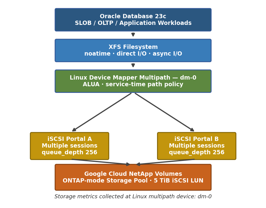

Figure 1 shows the Oracle over GCNV iSCSI I/O path.
End-to-end performance depends on every layer in this stack. Oracle issues physical I/O to datafiles on XFS; the filesystem passes I/O to a single multipath device that aggregates parallel iSCSI sessions across two portals; GCNV serves the LUN from an ONTAP-mode pool. Bottlenecks in any layer—cache, path count, queue depth, or ALUA policy—will show up in the results if not addressed.
Figure 1 — Oracle over GCNV iSCSI I/O Path
All storage performance metrics in this article were collected at the Linux multipath device layer: dm-0. (dm-0 is the Linux multipath disk device that Oracle uses for datafile I/O. It is used to measure and to report the IOPS and latency GCNV actually delivered to the host)
Reporting at dm-0 ensures the numbers represent what the array actually delivered to the host, independent of Oracle buffer cache or Oracle Automatic Workload repository (AWR) block accounting.

Performance was not achieved by a single parameter change. The recipe stacks Oracle, filesystem, multipath, and iSCSI settings so the database can drive parallel I/O all the way to GCNV. Skipping a layer—for example, measuring an individual path—typically understates achievable throughput.

The Oracle datafiles were placed on an XFS filesystem hosted on the iSCSI-backed multipath device.
XFS was chosen for mature Oracle-on-Linux support. Mount and log options were set to reduce metadata overhead during sustained random I/O.
Filesystem settings included:
  •       XFS
  •       noatime
  •       logbufs=8
  •       logbsize=32k
Multipath settings included:
  •       Device mapper multipath
  •       ALUA
  •       service-time path policy
The filesystem was mounted from:
dm-0
not from an individual iSCSI path.
iSCSI Configuration
iSCSI settings included:
Parameter
Value
node.session.nr_sessions
4
node.session.queue_depth
256
node.session.cmds_max
1024
The host used multiple iSCSI sessions and parallel paths to expose sufficient queue depth to the Oracle workload.
Multiple sessions per portal increase the number of outstanding I/Os the initiator can send to the array. Queue depth and cmds_max were raised from defaults to avoid artificial throttling on the host side during peak load.
