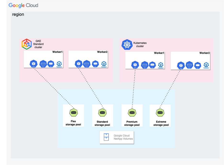

Great news! NetApp® Trident™ software is now generally available (GA) with Google Cloud NetApp Volumes. This means you can use the same Trident Container Storage Interface (CSI) provisioner you know and love to provision and manage Google Cloud NetApp Volumes persistent volumes on all your Kubernetes clusters in Google Cloud. They can be Google Kubernetes Engine (GKE) standard clusters, Openshift Dedicated, and/or self-managed Kubernetes clusters. So, you can have the performance and reliability of Google Cloud NetApp Volumes with many Kubernetes distributions—it’s entirely up to you.
This blog post describes NetApp Trident for Google Cloud NetApp Volumes for NFSv3 and NFSv4.1 and outlines how to configure it to support all the needs of your persistent Kubernetes applications. As an example, it uses a standard Google Kubernetes Engine (GKE) cluster along with NetApp Volumes Standard and Premium service levels backend, although the Extreme and Flex service levels are also supported. For more information on using Flex storage pools, see Seamless Kubernetes Storage with Google Cloud NetApp Volumes Flex and NetApp Trident.
What is NetApp Trident?
NetApp Trident is an open-source CSI provisioner that’s maintained and supported by NetApp. It automates the provisioning and management of Google Cloud NetApp Volumes resources for Kubernetes, simplifying the setup and teardown of persistent volumes and associated storage. It can even do snapshots of persistent volumes. (You can find more information about Trident at Learn about Trident.)

Ensure your Kubernetes cluster is on the same VPC peered to Google Cloud NetApp Volumes, and you have network connectivity.
Create secret and backend YAML files that allow Trident access to Google Cloud NetApp Volumes for your persistent storage needs. There are many ways to provision volumes to meet your application needs from different service levels to limiting volume size.
As an example, let's set up Trident to create volumes for our Kubernetes applications within the Google Cloud NetApp Volumes Standard and Premium storage pools, although Extreme and Flex Regional could be used as well.[Note: Flex zonal pools require Trident version 25.02 or later] The pools we will use need to be already configured in Google Cloud NetApp Volumes before the backend is created as shown below.  Create a Storage Pool gives more information on creating storage pools in Google Cloud NetApp Volumes.
