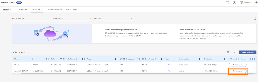

  1. Browse to storage->FSx for ONTAP-> Select the file system to view its well-architected status.
The well-architected status for that FSx for ONTAP system in the example below is listed as “Not Analyzed.” Click on the “Not Analyzed” button to select the system and begin its analysis.

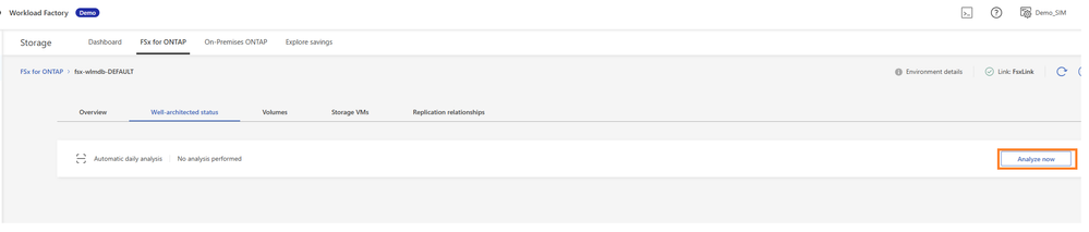

2. You will now be on the Well-Architected status page for the selected system. Click “Analyze Now” to proceed.

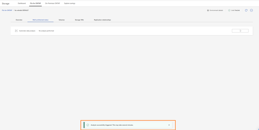

3. You will get a message “Analysis successfully triggered. This may take several minutes” at the bottom of the screen.

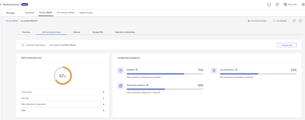

4. Once the analysis is completed, you will get an overall well-architected score as per the findings, and scores on the various categories such as Reliability, Operational Excellence, and Cost Optimization.
5. The well-architected total score quantifies the overall status of storage and provides a summary of findings, classified as critical issues, warnings, and well-architected configurations detected during the analysis. Scroll down to see the list of issues that were detected.

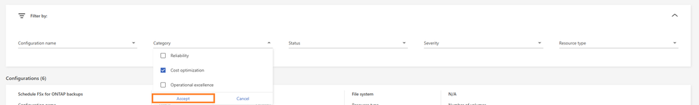

To review the findings by category, you can apply filters. As an example, select “Reliability” from the Category drop-down menu and click “Accept” to continue.

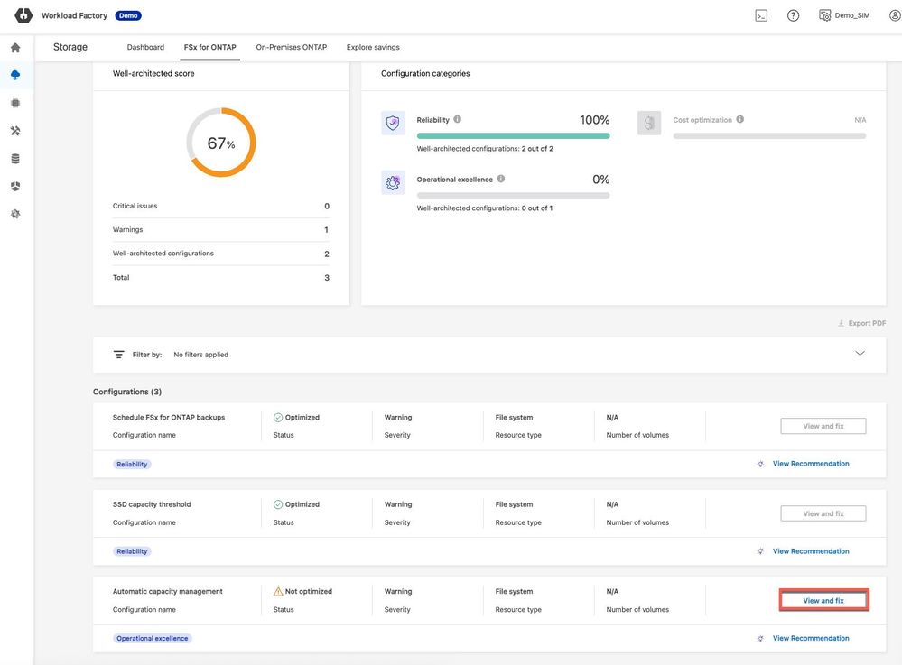

6. You will now see a list of all the findings about specific storage configurations. Listed next to each configuration is the current status, the severity of the finding, the resource type, details about the resource type, and the “View and Fix” button.
Let’s take a closer look at some individual configuration finding examples.

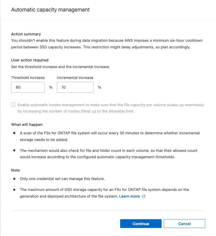

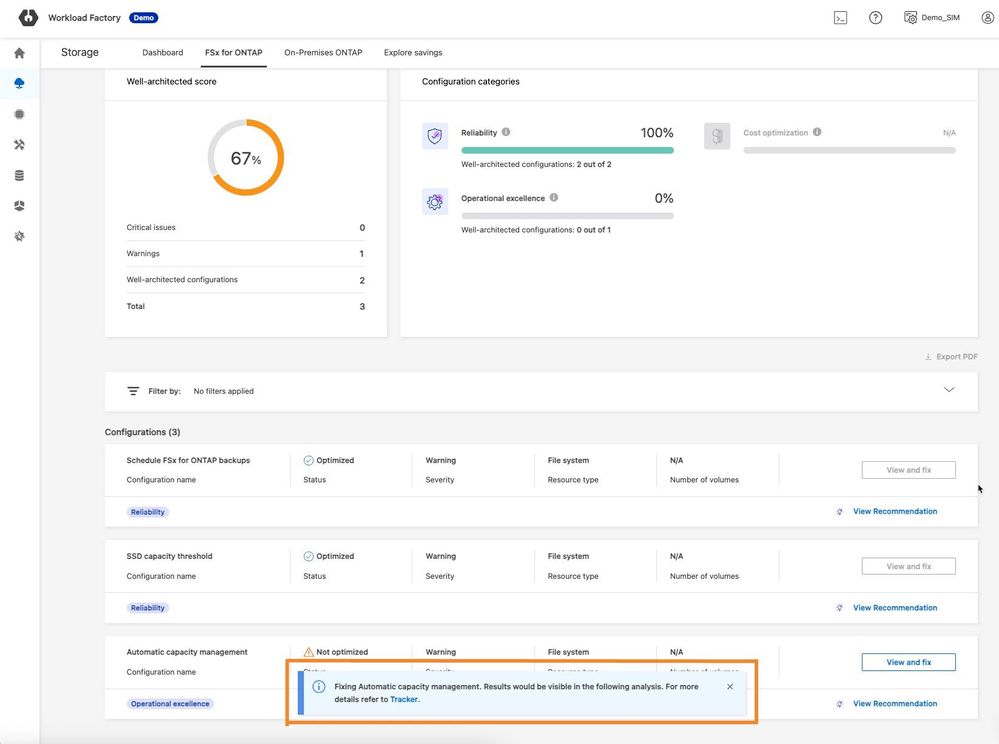

Automatic capacity management: You’ll notice that workload factory determined that this configuration is not optimized, and the warning states that this is a security issue. To fix this, just click the “View and Fix” button.
A pop-out screen will now walk you through the fixes for automatic capacity management. You’ll need to determine the threshold increase and incremental increase. The default settings you see here will be automatically recommended based on best practices for storage headroom.
Click “Continue” to proceed.
You will now receive a status message at the bottom of the screen stating the changes have been made and the system is being adjusted. You can see the progress of the changes by clicking the Tracker link.

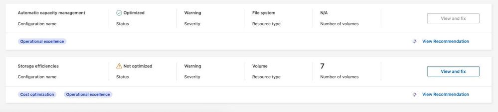

8.  Storage efficiencies: NetApp offers proprietary storage efficiency features including thin provisioning, data compression, deduplication, and compaction. These features help reduce the SSD tier capacity and cost. If this option is not enabled, workload factory will flag this as not optimized, as shown here.

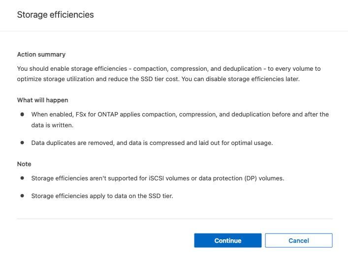

Clicking the “View and fix” button will open up the pop-out screen, which will introduce what the problem is and how to fix it.
Click “Continue” to proceed with the fix.

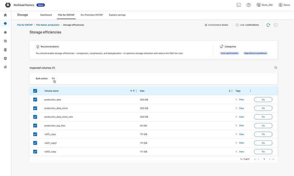

You’ll now be shown a list of all the volumes that have been impacted by the lack of storage efficiency features. You have two choices here:
  1. Select an individual volume and click the “Fix” button at the end of each volume’s listing to enable storage efficiencies.
  2. Select multiple list items and click “Bulk action: fix” at the top of the list to enable storage efficiencies on all the selected volumes.

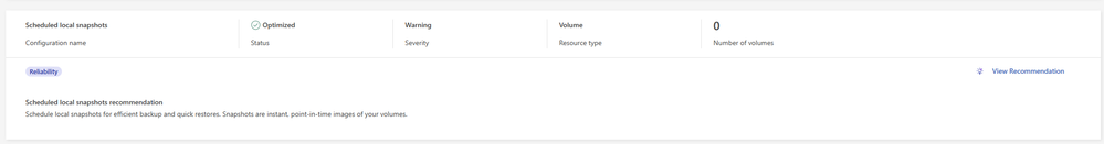

9. Scheduled local snapshots: Local snapshots are point-in-time copies of volumes that can be used for quick backups and restores. If local snapshots are not configured, workload factory will flag this during the well-architected framework analysis.

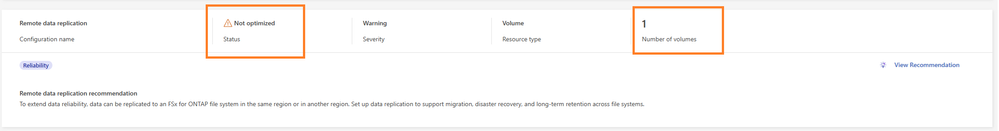

10. Remote data replication: FSx for ONTAP offers the ability to replicate data across file systems within the same region or to another region. Data replication can be configured to support various use cases, including data migration, disaster recovery, backup, and more. If this configuration is applicable for the file system but is not enabled, the status will be flagged as “Not Optimized” and show the number of volumes that are not aligned.

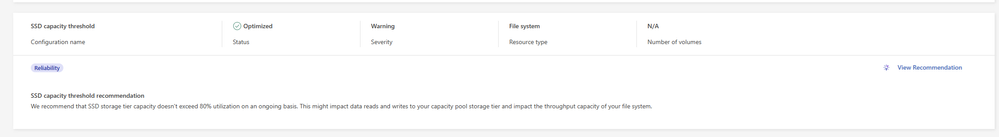

11. SSD capacity threshold: To maintain optimal performance, it’s advisable to keep the SSD storage tier capacity below 80% utilization. Exceeding this limit might negatively affect the speed of data reads and writes within your capacity pool storage tier, and potentially reduce the overall throughput capacity of your file system. If this threshold is exceeded, the workload factory analysis will flag it as “Not Optimized.”
12. Next, let’s examine some recommendations for the Cost Optimization pillar. Use the Category drop-down menu to filter Cost optimization pillar findings. The results for several categories will be shown.

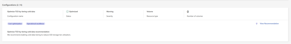

13. Optimize TCO by tiering cold data: Data tiering is used to reduce SSD storage tier utilization. If it’s not enabled, the workload factory analysis will flag this as a finding.

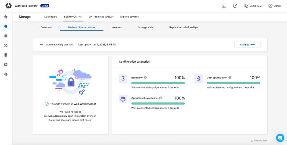

14. If you’ve decided to follow all of the recommended optimization suggestions, your score will be replaced with a message saying that your entire storage configuration is now Well-Architected.
