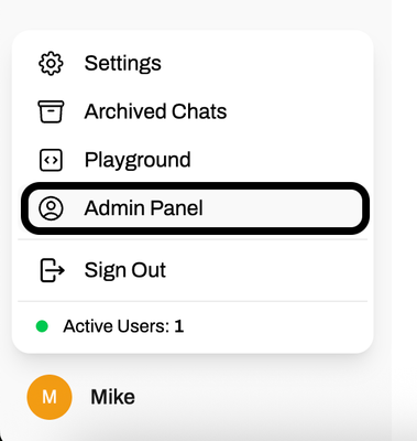

If you did not configure SSO integration in your open-webui-values.yaml file, as I did not in the preceding example, then you will need to create accounts for your users via the admin panel. To access the admin panel, click on your name in the bottom-left corner of the screen, and then click on 'Admin Panel.'

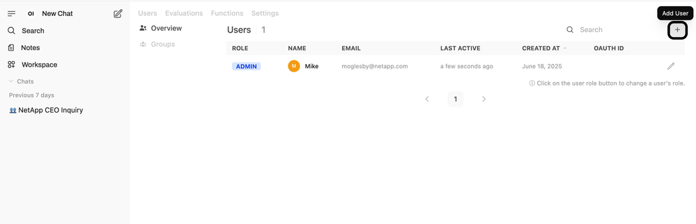

 To add a user, click on the '+' icon in the top-right corner of the screen.

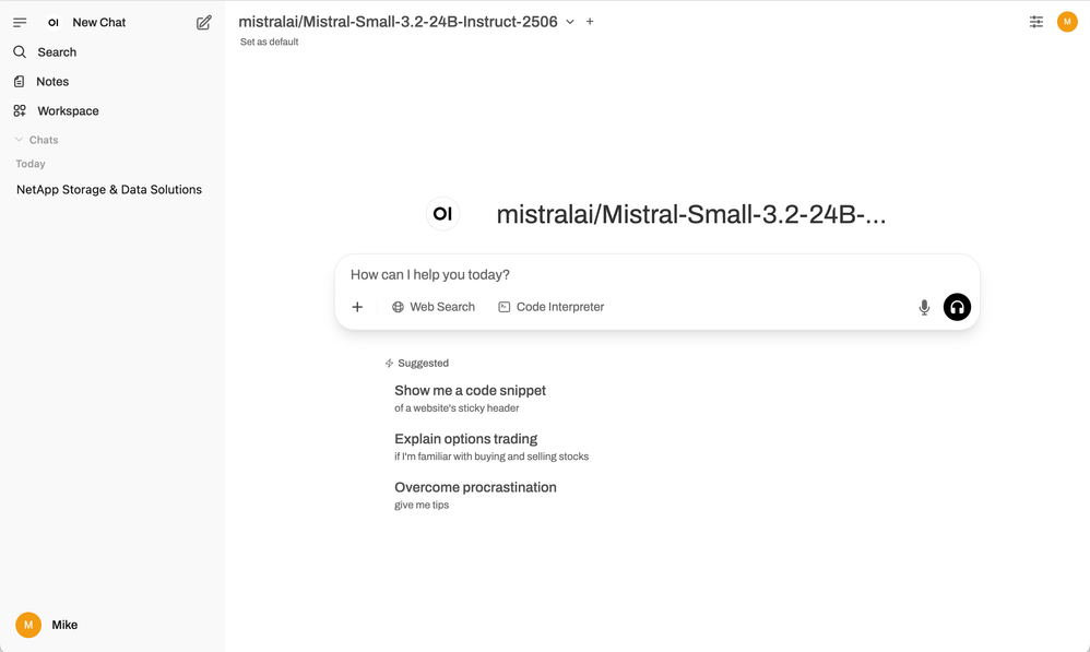

You and your users can now chat with your vLLM inference server! You are now a GenAI superstar, and it only took a few minutes!
