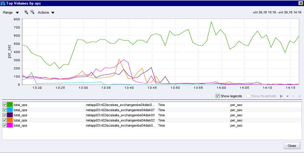

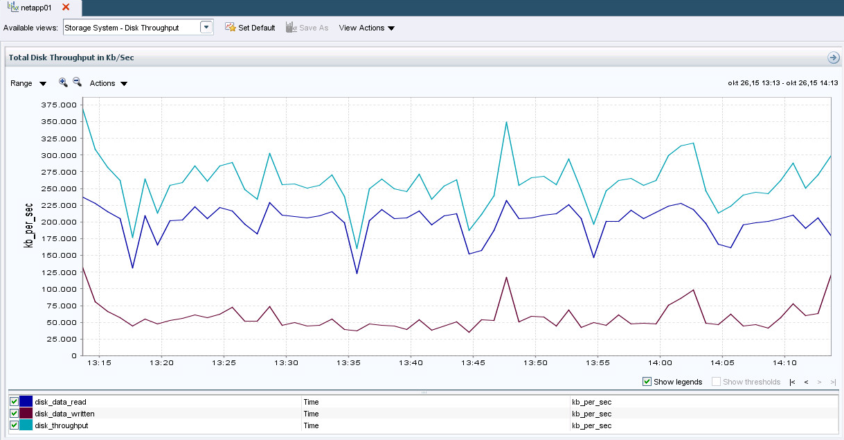

I would like to know if this is also the case in the DFM Performance Manager couters like "Disk Throughput":
Or maybe also here in the Volume ops ?
Or does DFM realize that this is a MetroCluster with a Mirrored Plex and device the IOPS ?
/Heino
