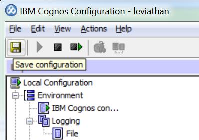

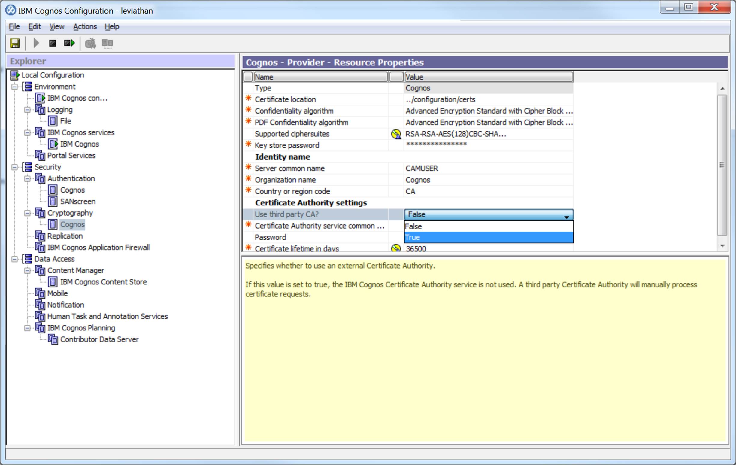

Now, open IBM Cognos Configuration
We need to change Cognos to use a 3rd party CA
Save the Configuration by clicking the floppy disk icon (if you are under 35 years old, ask someone older what a floppy disk is)

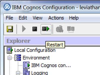

Restart the Cognos Services by clicking this icon:
A Window will popup, logging all the events as Cognos services recycle - you may see an error if you have NOT configured SMTP as it will attempt to test it. When things are back up, log into the OCI DWH reporting portal on tcp 9300 - you should no longer see warnings about certificates
