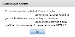

Here is the log output for the failure:
2016-10-24 14:12:43,304 WARN [com.netapp.wfa.ui.ExecutionFacadeImpl] (default task-28) Method validateCredential("HOSTNAME....","RemoteSystemType{id=...") threw:: javax.ejb.EJBTransactionRolledbackException: Credential validation failed. Connection to HOSTNAME.com failed (13001: Failed to get the hostname corresponding to the server: HOSTNAME.com. Please provide a fully qualified domain name of the server or use HTTP 1.0)
--- SNIP ---
Caused by: CommandExecutionException{Message: Credential validation failed. Connection to HOSTNAME.com failed (13001: Failed to get the hostname corresponding to the server: HOSTNAME.com. Please provide a fully qualified domain name of the server or use HTTP 1.0), Cause: null}
Please let me know how I can further troubleshoot this issue. Thanks!

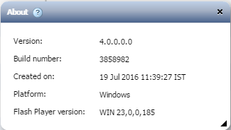

EDIT: Using WFA v4.0.0.0.0

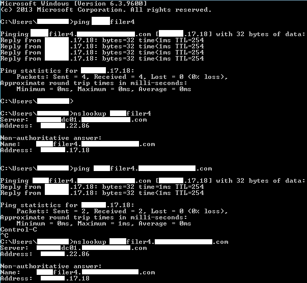

Hello, thank you for your response. I have opened a command prompt on the WFA server. I did a ping and an nslookup for both the short name and FQDN for the filer host. They were successful in returning the correct IP address. Does this test confirm that DNS is resolving correctly?
Is there a way I can specify DNS servers for WFA?

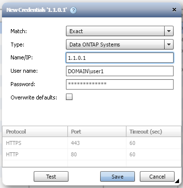

Can you paste the screenshot of how are you currently providing the credentials which is throwing the mentioned error.

Can you try providing the credentials like below:

I tried the credentials as suggested, it did not work.

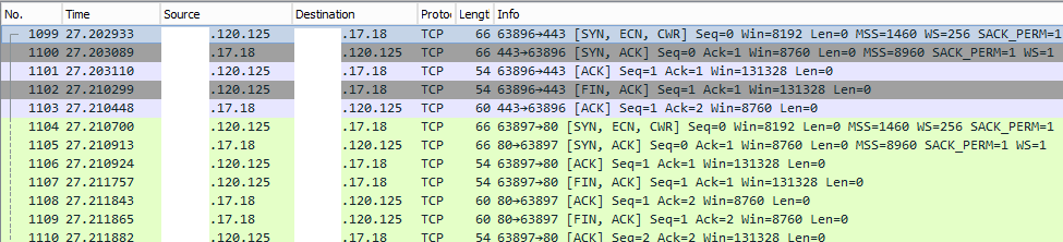

I have taken a packet capture of the connection attempt to the filer. I can conclusively state that DNS is supplying the correct IP.
The TCP handshake is completed for both port 80 and port 443, but nothing further happens afterwards. The connection shuts down without ever making a formal HTTP request.
The .17.18 machine is the filer, and the .120.125 machine is our WFA virtual machine.

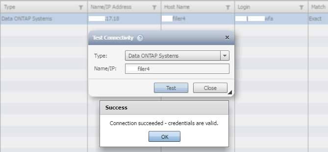

Embarassingly, this is what ended up working. It doesn't make any sense to me, given what I've posted previously for my DNS testing, but this was the solution.
Thank you!!

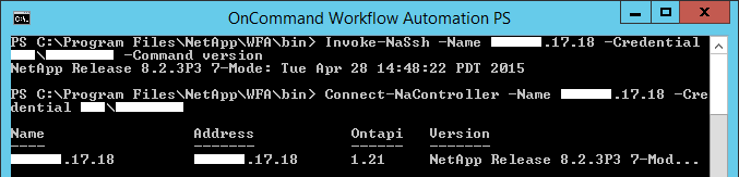

I don't have a 7Mode system with me, but now I'm beginning to think it may not be a WFA issue.
You said that you can do SSH and connect to the 7Mode controller. WFA credentials for ONTAP uses perl and HTTP protocol to connect to the controller.
Now is your 7Mode controller configured for domain login using HTTP?
Do this below test:
1. go to WFA\bin
2. Launch the file ps.cmd
3. Try the below command:
Invoke-NaSsh -Name <filer-ip> -Credential DOMAIN\user1 -Command version
Provide password when prompted for.
if 3 Passed, and it should since you say SSH works for you.
4. Try the below command
Connect-NaController -Name <filer-ip> -Credential DOMAIN\user1
provide the results here.

@sinhaa
Here are the results of the testing, everything looks like it is connecting as it should:
