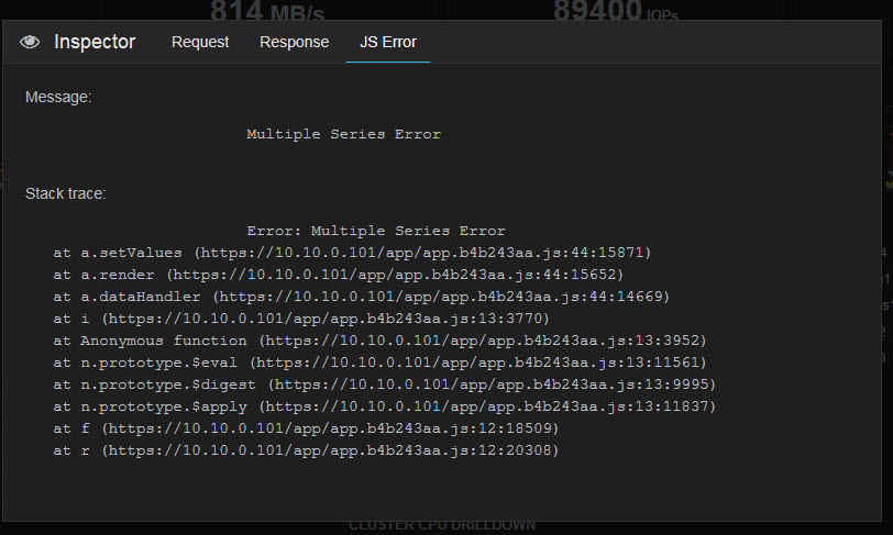

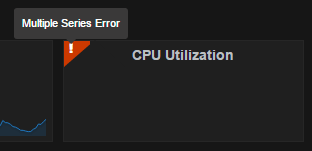

Grafana released version 2.5 recently and there are some interoperability issues with dashboards provided by Harvest 1.2.2.  At first glance, I discovered that some singlestat panels report a "Multiple Series Error" that looks like this:
I modifed all impacted dashboards and they are ready to go.  See this blog post for how: http://blog.pkiwi.com/grafana-2-5-support-with-netapp-harvest/

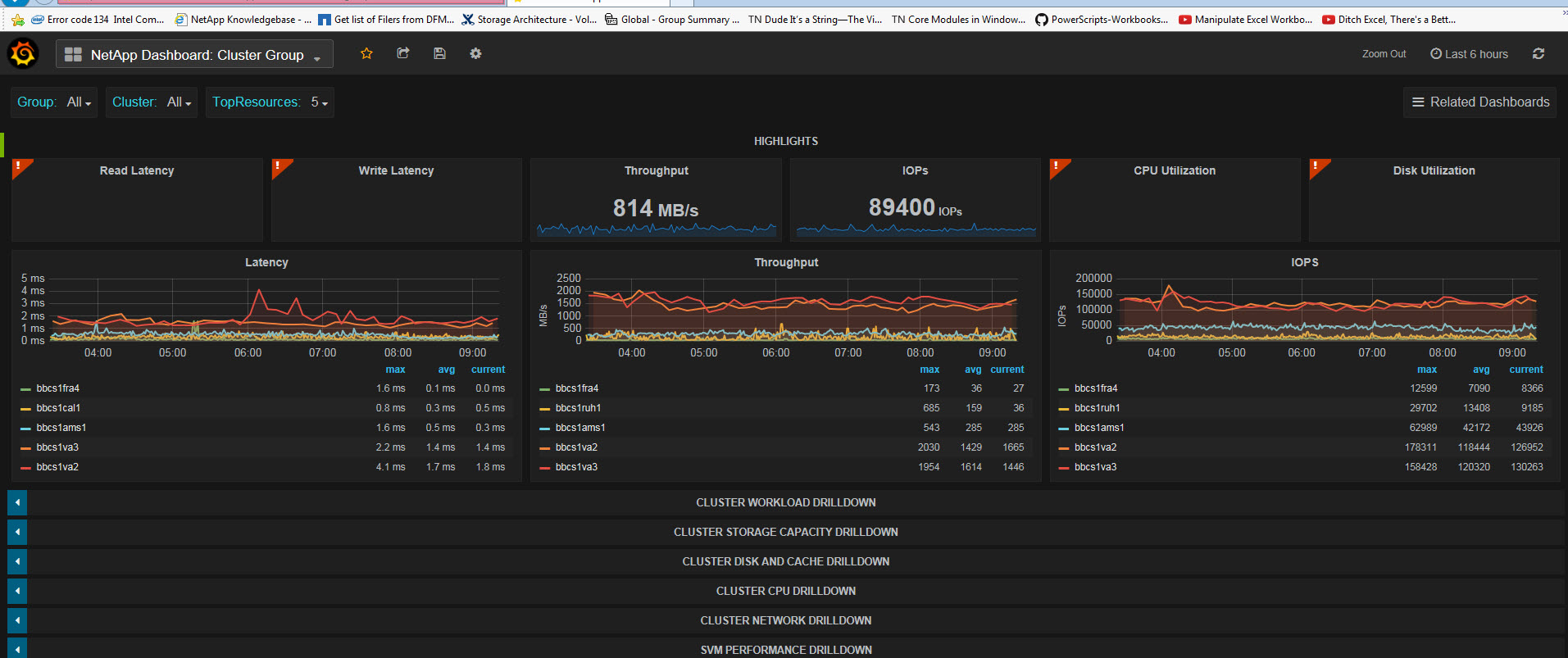

I am still getting these errors.  Is there an easy fix to them?  It only works if I select 1 resource.  I'm on the latest versions of Harvest and Grafana.
madden
13,693 Views
Hi James,
Did you update to the latest dashboards combatible with Grafana 2.5?

James_Castro
13,690 Views
Yes.  After a quick reboot they worked.  Thanks!
