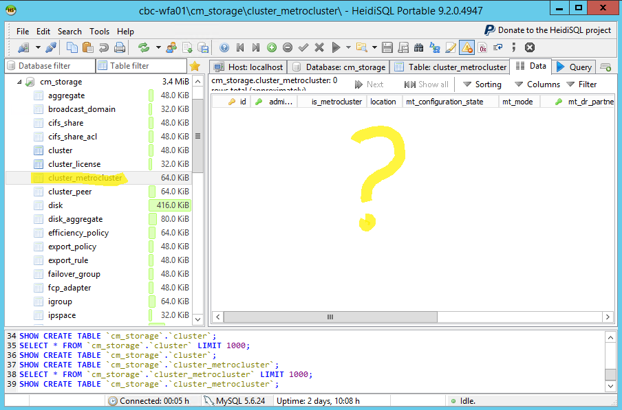

Please check if the 'cm_storage.cluster_metrocluster' table is populated.

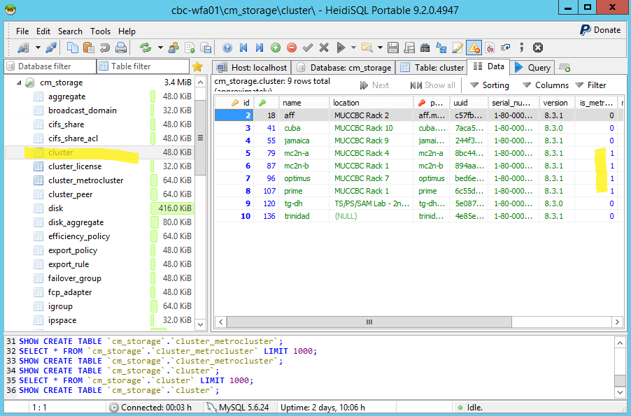

The table cm_storage.cluster_metrocluster is empty.
But the MetroClusters do appear in the table cm_storage.cluster.
regards, Niels

using OCUM 6.3RC1. Alredy reseted scheme several times. Acquisition successfuly but the cm_storage.cluster_metrocluster table stays empty.
The table cm_storage.cluster shows the field "is_metrocluster" as "1" though for my MetroCluster systems.
It looks as if those systems don't get transferred/copied to the cluster_metrocluster table.
regards, Niels

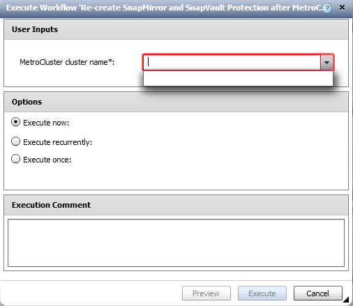

Well - although I can now select a MetroCluster in the workflow dialog, I get a whole new set of issues...
First - the workflow "Re-create SnapMirror and SnapVault Protection after MetroCluster Switchover workflow" doesn't seem to do anything.
Although I have SnapMirror and SnapVault releationships configured on both clusters of the MetroCluster setup, there is only one step performed during execution of above workflow after I performed a switchover:
This in turn leads to  - well - nothing...

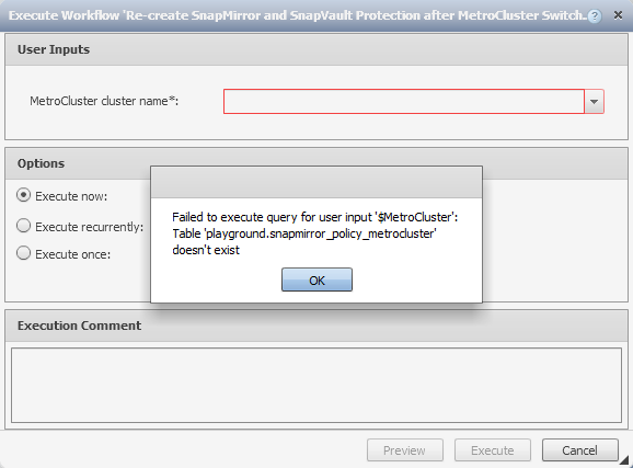

Second - I get a WFA error when I select the "Re-create SnapMirror and SnapVault Protection after MetroCluster Switchback workflow" without even having clicked on anything within that workflow dialogue:
Kind regards, Niels

9,244 Views
Hi Niels,
You seeing this issue,  because of  following reasons ,
  • Looks like the SnapMirror relations are not acquired by OCUM.
    • Resolution: Before running Switchover acquire the OCUM
  • This workflow will capture only SnapMirror and SnapVault relations between Metrocluster as destination with non Metrocluster as source.
Note: Once Metro cluster switchover happens, the Metrocluster switchover data will be available after 45 minutes in WFA (in OCUM after 15 min and from OCUM to  WFA 30 minutes).
If we need data immediately, we need to rediscover the cluster in OCUM and Acquire the WFA data source.
Second issue
  • The issue is seen because tables are not available,  These tables will be created once we run second workflow “Retain SnapMirror and SnapVault configurations before Metrocluster Switchback”
 Regards,
Veerendrnadh CH
