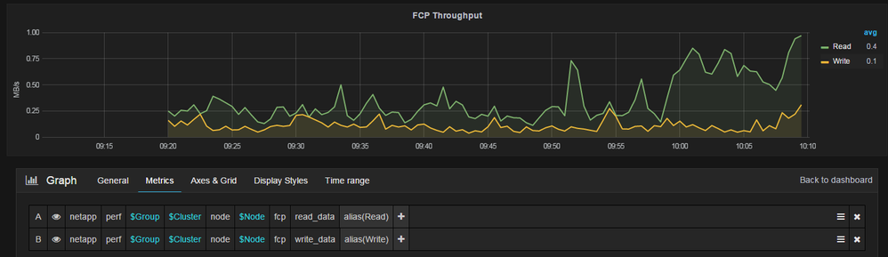

Here is what I am seeing.  Throughput for everything seems to be badly off.

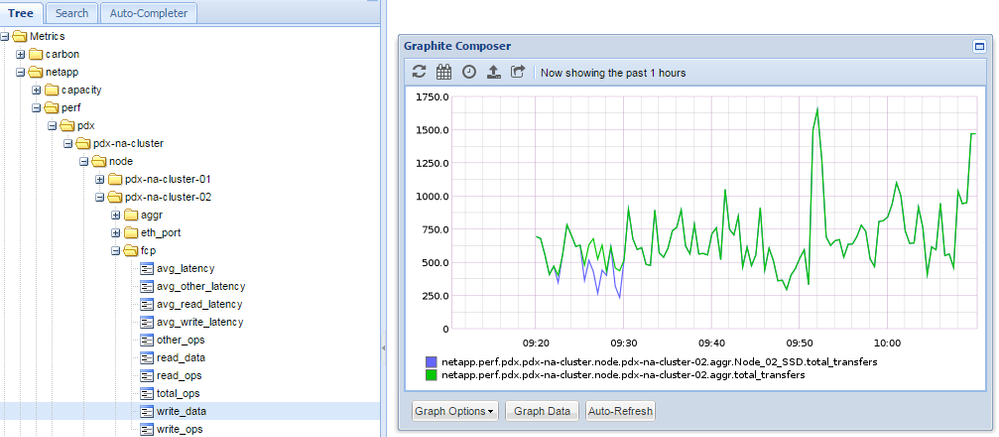

In Graphite I see the correct speeds.  But in grafana, everything is off.  As best I can tell this seems to apply to all throughput values.  So NFS/CIFS/FCP/Disk...graphite.pnggrafana.png
Any ideas?

If you look carefully at your first image, with the raw graphite data, you'll see that while on the left you've highlighted write_data, in the legend for the graph you're showing the metrics:
...aggr.total_transfers  and ...aggr.Node02_SSD.total_transfers.    Remember that the graphite interface will show each metric you double click, and it removes them when you again double click them.   Its easy to end up looking at a bunch of unrelated items this way.
In your grafana dashboard you're looking at Node.xxx.fcp.read_data and  Node.xxx.fcp.write_data.     These don't measure the same things.    Aggregate total transfers does not equal protocol reads+writes for a node.    Each aggregate is measuring its own operations to and from disk.   The protocols are each [FCP, iSCSI, CIFS, NFS] measuring their operations from and to the client.    Depending on what you're wanting to measure you'd look at one or the other or both together but they will not show the same values.

Non of the throughput values seem correct in grafana.  Not just that one.  I know I am pushing 400~600MB/s on average through my FAS8060, but grafana is showing 0.4~1.2MB/s.  So there is something off, I just have no clue where to look.

I just did a comparison to the values below in grafana with Brocade Switch View for the physical ports in my environment.  (Because I'm comparing to physical ports, I have to look at the node's physical port values, not the SVM LIF values, or I'd have to do a bunch of math.   This is the metric that you show on the left side in the initial screenshot of graphite, but not the metric you were actually displaying.)
I use the  Network Port dashboard  and  reference these metrics in the Fibre Channel row.   (Metrics captured by choosing edit on the graph).
netapp perf $Group $Cluster node $Node fcp_port $Port write_data highestAverage($TopResources) aliasByNode(5, 7)
netapp perf $Group $Cluster node $Node fcp_port $Port read_data highestAverage($TopResources) aliasByNode(5, 7)
When I check these values against the Brocade values I'm in alignment, with minor variation because the Brocade switchview GUI is displaying 30second averages to Harvest's 1 minute averages.
What do you see when you look at the values above in Grafana either on your own dashboard, or using the one provided in the package?
 EDIT:  Note the bold piece is different than what you were showing in grafana.

DingbatCA
10,515 Views
I feel like a n00b.  Thanks for pointing me to the "normalized_xfer"
cat netapp-harvest.conf | grep normalized_xfer
normalized_xfer   = mb_per_sec
normalized_xfer   = gb_per_sec
Changed to mb_per_sec, for the 3 involving netapp and everthing is now lining up perfectly!
