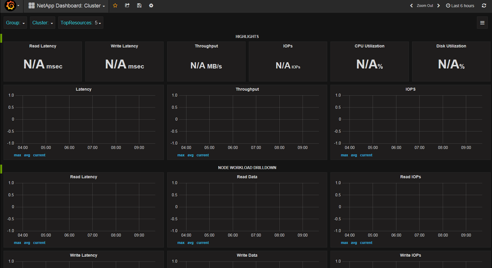

Recently installed Grafana and Graphite but the only metrics that are showing up are the "Graphite Carbon Metrics".
Any other metrics are not showing up, I've posted a screenshot of the "NetApp Dashboard Cluster" below.
In Graphite, the Carbon metrics are the only ones that are showing up as well.  Does anyone have an idea on what may be the problem here?
