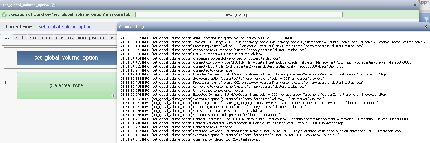

Here is the example output (note it is connecting to multiple clusters and vservers to set all thick provisioned volumes to thin provisioned volumes)
set_global_volume_option

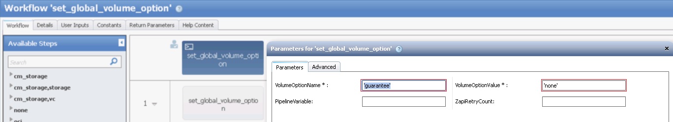

You could also use this WFA workflow to set any other volume option globally in your environment...just set the input parameter values. EG
