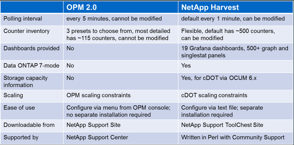

OPM has only some basic counters, it lacks the details.
Here is an comparison overview: https://twitter.com/dutchiechris/status/652432912596373505

Use them both for best results.  Harvest will query metrics directly from your controllers, but can also get many other metrics from OCPM.  Capacity metrics I think are only available when Harvest queries OCPM.
We use both, and frankly I find I much favor Harvest/Grafana.  Takes a little work to get it going, but that looks much easier with 1.3 release.

Hi, can you provide an alternate link (or the actual content) to the OPM/Harvest comparison? My company blocks Twitter...
moep
9,508 Views
Here is the picture from the twitter post.

That chart is for a really old version.  OCPM is at version 7.0 (and 7.1RC) and is much improved over 2.x.  That said, I still wouldn;t rely on it alone, without Harvest.
