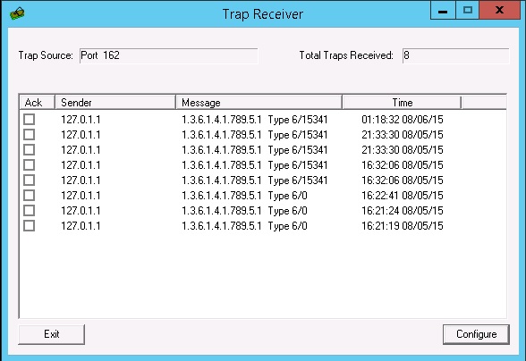

Hello All,
I am using OnCommand Unified Manager for Clustered OnTap version 6.2 (vApp or .ova Deployed)
We have setup an alarm and trying to send it to a Trap receiver.
But when looking at the trap receiver, the sender is showing up as 127.0.1.1 instead of the actual server name.
Am i missing anything or this is how this bahaves ?
do we have any workaround to fix this...
I also tried to make sure that we have a proper DNS recored available so it should resolve to both IP and Name.
,Sheel

Midhun_Vijayan
10,457 Views
Its a problem with SNMP v1. It is fixed for SNMPv3. But you should be having SNMPv3 trap server in your environment.
Here is the work around If you are using SNMPv1.
1) Boot OCUM appliance into shell prompt. How? Login to the ESX vcentre where VM resides. Take a snapshot of the VM. Proceed to launch console from vcenter. Give admin/your_password.
Go to option 4 ) Support/Diagnostics, type 'erds' in the section asks for 'Enter your choice:'. It will ask you to enter password. Set a password. Access will be enabled only for the first terminal session.
2) Login to the cli by giving username as 'diag' and the password you set above.
3) Note the IP address of the OCUM from 'sudo ifconfig'
4) edit /etc/hosts file with vi or nano
5) Set host file as below.
127.0.0.1 localhost
<ip address of the ocum> <hostname_with_fqdn> <hostname>
::1 localhost ip6-localhost ip6-loopback
fe00::0 ip6-localnet
ff00::0 ip6-mcastprefix
ff02::1 ip6-allnodes
ff02::2 ip6-allrouters
6) Reboot the ocum server.
7) Try sending alerts now. Try disabling ipv6 settings in /etc/hosts file if that's still not working.
Following these steps will fix the issue.
