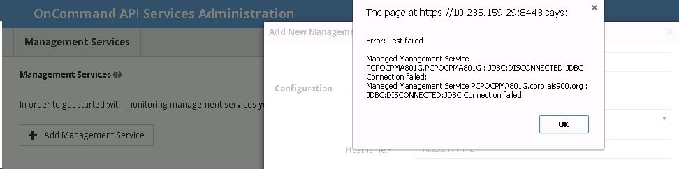

but for the Performance Manager i can't see the Integration Schema role.
i did try to create user with database role but it doesn't work during test connection on the API service server.
the error show as below:

Please verify your dns configuration and hosts file on the API Services Server.

OPM database user has no Integration Schema role. That was a documenation error. I have logged a bug and it will be corrected.
Dababase user with database role should have worked. Please follow Nimit's instruction and see if the problem is resolved.
