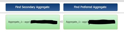

Thanks for the feedback. I threw together a workflow to help visualize just this issue as to not overcomplicate things. It is now attached.
In my environment, the second step (called Find Preferred Aggregate) is always coming back as disabled, which is not expected, while the first step does return an aggregate, as expected. I've attached a screen shot of this scenario.
In my case if I change the second step from "If aggregate2 was not found: Fill-in attributes for aggregate2 and execute the command" TO "Disable this command" only then does it return an aggregate (as seen in the next image).

Sinhaa is right, this is not very easy to discuss in general terms, but I'll make an attempt.
One thing you need to realize is that the planning phase of workflow execution is not a linear process.  When the advanced tab talks about "if this object was found/not found", it does not mean in a previous step.  It means after planning is complete, possibly in a later step.  This is why you cannot have a search step that says "find this object now, if you haven't already found it."
So how can you actually achieve what you are trying to do?  I can think of two ways, but both are a bit clumsy.
1.  Create a search step for aggregate1.  Create a second search step for aggregate2.  Every time you wish to use your aggregate in a subsequent step, create two instances.  Set one to "if the following variable was found: aggregate1" and use aggregate1.  Set the other to "if the following variable was not found: aggregate1" and use aggregate2.
2. Create search steps for aggregate1 and aggregate2 as before.  Create a third search step for aggregate3 and use the filter "Select one Aggregate by its natural keys" .  For the keys, enter something like "aggregate1._found == true ? aggregate1.node.name : aggregate2.node.name".  Use aggregate3 in all subsequent command steps.
Hope this helps.
