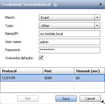

Here is the PowerShell code from a WFA workflow i've used in my environment to successfully set OCI annotations on internal volumes.

         $Hostname    = Get-WfaRestParameter "host"
         $Port        = Get-WfaRestParameter "port"
 	     $Credentials = Get-WfaCredentials -Host $HostName
   $Username    = $Credentials.Username
   $Password    = ConvertFromSecureToPlain -SecurePassword $Credentials.Password

I have added sanscreen  host creadential in WFA and tried to run it and its failing at "Failed enumerating API login information from OCI server", what I might be missing?
also, what is the way to provide credential directly in CLI?
the $username and $password parameters are not discovered automatically when I click on discover parameter?
mbeattie
12,331 Views
Hi,
The username and password are enumerated from the credentials varialbe which is set by retrieving them from the WFA credential cache using:
 Have you added credentials for the OCI host and set the port and timeout?
Note: You might need to modify the port number to meet your requirements
/Matt
If this post resolved your issue, help others by selecting ACCEPT AS SOLUTION or adding a KUDO.
CAPATEL_NET1984
12,315 Views
Matt, I did added as you showed above, also I throw the user name in script  and confirmed it can get right user name also. I think the issue may be in header. can you give me a command where i can simply replace the put comamnd you ahev with my user name and password for testing purpose and see if it can work, then I can confirm it must be something with the creadentials.
for ex:
 $A   = Invoke-RestMethod -Method PUT -Uri $Uri -Headers $Headers -Body (Set-OCIAnnotationFields $AnnotationName $AnnotationValue)
insted of $header what should i do to supply user name and password in above line directely?
appriciate your help.
