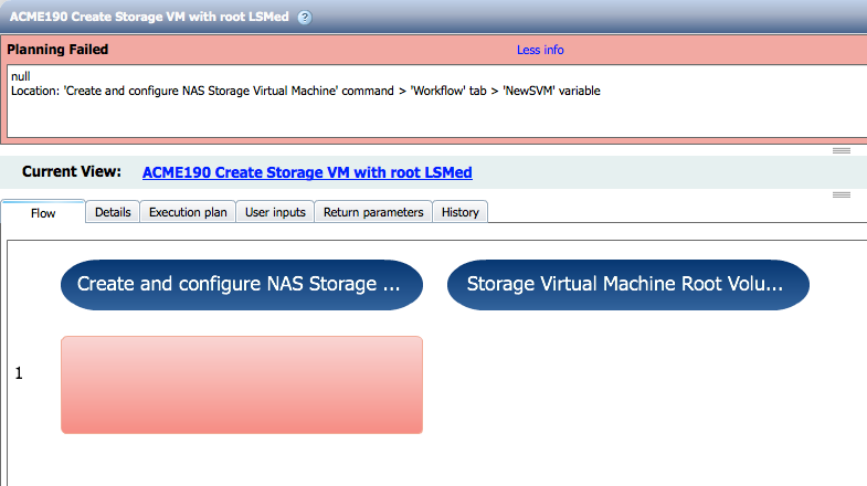

I'm stuck by a WFA 3.0rc1 Preview Planning Phase error the just says 'null'. I've attached the workflow and logs generated. The workflow is an attempt to test 3.0's ability to use workflows as steps. I've created a very simple 2-step workflow that calls two built-in sample workflows: A) Create an SVM and B) SVM root volume protection (LSM). To keep it simple I've hardcoded alot of the workflow paramters and so it only asks for $cluster, $svm and $aggr. Wondering if anyone else can re-create and.or resolve this.

Anyway, I was able to replicate your "null" error scenario. It seems like a bug as of now in WFA. So the issue is:
- The child workflow "Create NAS SVM" used in your parent workflow "ACME..." uses the command "Create and configure SVM" which in turn has a password type parameter.
- When there is no value provided to the password command parameter in the child workflow definition, the part of the product that tries to mask password parameters in child workflows has failed leading to the null error message issue.
I tried the following to get your workflow preview succeed. Can you please try the same with both preview and execution and let us know:
- Clone the sample workflow "Create NAS SVM"
- In the first box, i.e parameters to command "Create SVM" -> Other Parameters tab -> ADAdminPassword parameter, provide some dummy value 'dummy'
- Now use this workflow instead of the standard sample workflow in your "ACME.." parent workflow
- Try this out and let us know. Please try both planning and execution to ensure there are no surprise failures in execution.
The workaround I am suggesting is not so good as it involves cloning the sample workflow.
I will get back to you if there is a better workaround available.
Thanks,
Shailaja

Ok. Thanks. I guessed, that you must have eventually given the right parameters, since wrong parameter values would have thrown the right error message.
Thanks,
Shailaja

Yes, That corrected the problem. The first step (child cloned-sample workflow to create SVM) previewed and executed fine.
However, I had to remove the second step (Create Load Sharing Mirrors) as it exposed another problem. That workflow (certified sample for creating loadsharing mirrors) assumes the vserver/SVM exists, and a preview was failing in that WF step. So I took it out for now. I think that problem is that at 'Preview' time it is attemping to resolve resources against the WFA cache and, of course, the vserver doesn't exist in cache. Haven't had time to run that problem down.

I can confirm on WFA 3.0GA and OCUM 6.2GA that the 'null' bug you mentioned still persists when nesting workflow 'Create and configure NAS Storage Virtual Machine' in another modular workflow. The workaround you suggested of a 'dummy' password set on the 'ADAdminPassword' field still works.
Could you add/copy me on bugs 899641 (& 878092 if it is still an issue) as well?
