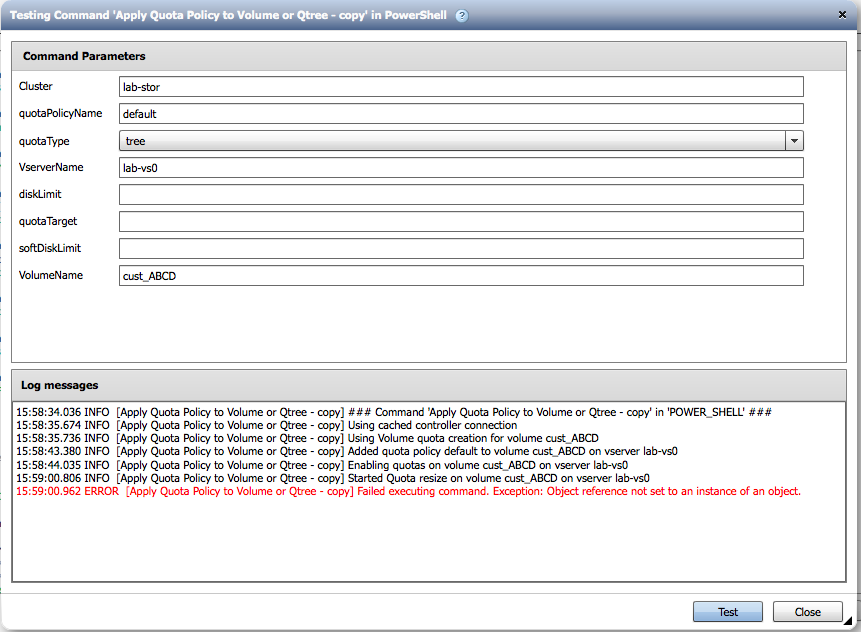

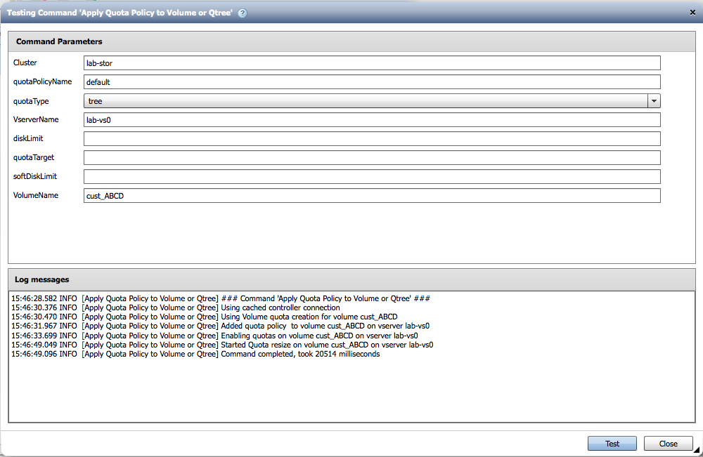

I have narrowed the problem down to a single command and can reproduce the problem very easily. However, I can't seem to fix it. But I believe importing this single custom command into both a WFA 3.0P1 and WFA 3.1RC1 system will easily show that it works in 3.0P1 and throws the odd 'Object reference not set to an insance of an object' error. I say that is an odd error because I'm only used to seeing that error at Preview time referring to an object reference in a Command Parameter field of a workflow. I know how to deal with that issue.
However here, the error appears at the end a PowerShell command. Actually, the PowerShell command appears to me to execute entirely and correctly. It is just that at the end of running this exception error is thrown and that causes the command (and workflow if running within a workflow) to fail. But the comamnd correctly adds the 'default' quota policy to the volume and even enables quota resize as it should. So it works, but still blows up the workflow it is within.
I'm going to attempt to attach these three things here:
    1) screenshot showing the command running (with Command Test Button) fine under WFA-3.0P1,
    2) a screenshot showing the command running but throwing the error on a WFA-3.1RC1 system
    3) the ,dar file holding just the command: "Apply Quota Policy to Volume or Qtree" (I added .txt to the end of .dar file name)
1) running OKay on 3.0P1
2) running with the ERROR on WFA 3.1RC1

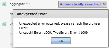

I am also facing the same issue, with 3.1RC1 and later i found its an issue with the referencing.
when i try to click on the Already applied filer i get this error, and to solve it i have to delete this reference and recreate a new reference (apply Filter)
,Sheel
anuk
20,443 Views
Hi Sheel,
    The issue you are facing is related to null pointer exception. Somewhere in UI, some object with null value is getting accessed. Could you please share the logs and workflow with us to debug the issue?
Thanks and Regards
Anu

Hi Sheel,
   I am able to reproduce the issue with the attached dar. Could you please mention the WFA version on which the workflow is creaeted? And also register the case with netapp support team with the bug id 933928.
Thanks and Regards
Anu

chandank
17,076 Views
Hi sheel,
I have narrowed down the error popup being shown in the UI. Seems the content from 3.0 didnt get correctly upgraded to 3.1.
I tried to reproduce this by creating a similar workflow in 3.0 and upgrading to 3.1 , but i didnt hit the issue.
It would help me if you can you please share the 3.0 backup of the system if possible ?
