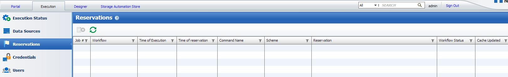

I'm referring to the user specific reservation tab, and not the reservation scripts that you could find on objects.
Reservation tab

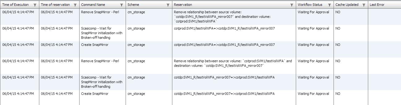

It's as you said, when starting the workflow here is the kind of reservation I have :

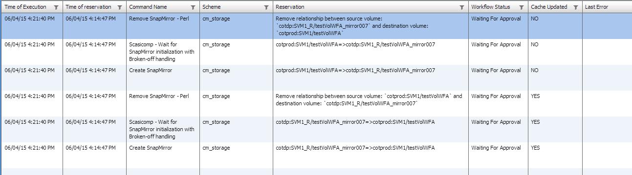

When I execute the acquisition via the same command outside the workflow (with the same inputs), it actually works :
EDIT : And the acquisition from the workflow should work, as it updates the cache database and I can see the events in OCUM as well as WFA on the right data sources and clusters.
