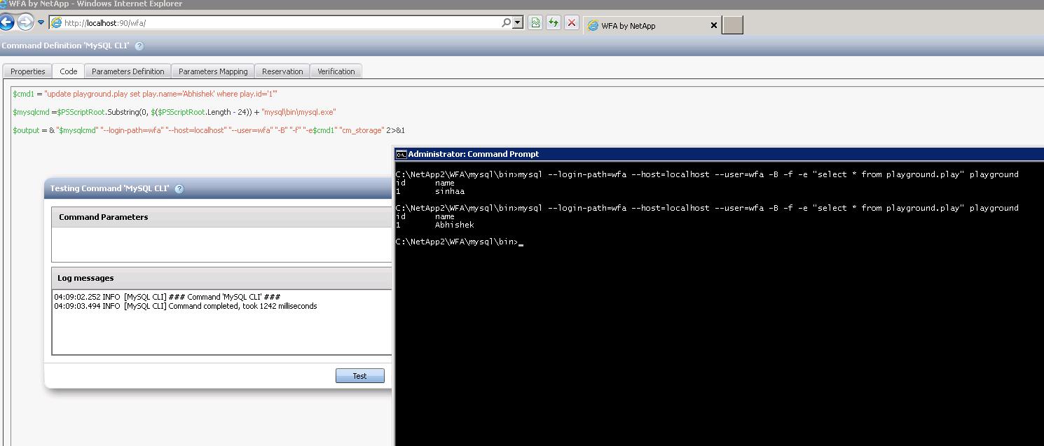

Approach 1:
  1. Create a new mysql login-path for wfa
  Open a cmd prompt as “Administrator” on WFA and do the following.
C:\Program Files\NetApp\WFA\mysql\bin>mysql_config_editor set --login-path=wfa --host=localhost --user=wfa --password
Enter password:
Enter Wfa123 as password.

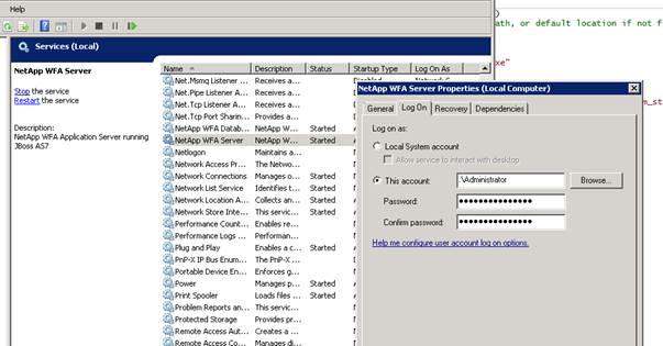

2. Change properties of NetApp WFA Server service to start it as any Administrator account and not LocalSystem (Default).
Once done you would need to modify your command code in the line where you are using mysql.exe
3. Modify your command code in the line where its using mysql.exe. Now this depends on the code. A sample is below, understand and see if you can can modify it. If you give your command code, i'll return you with the fix.
$pwd = Get-Location
$mysqlcmd = $pwd.Path+"\..\..\..\..\mysql\bin\mysql.exe"
$MySQLDatabase = 'playground'
$MySQLHost = "localhost"
$MySQLLoginPath = 'wfa'
$MySQLAdminUserName = 'wfa'
$cmd1 = "SELECT * FROM cm_storage.cluster"
# Attempt Command Execution via mysql.exe
$output = & "$mysqlcmd" "--login-path=$MySQLLoginPath" "--user=$MySQLAdminUserName" "--host=$MySQLHost" "-B" "-f" "-e$cmd1" "$MySQLDatabase" 2>&1

Are you sure about this Access Denied Error is coming still after making the changes I suggested. By default the DB user 'wfa' has ALL PRIVILEDGES on playground. So unless any grants modified on a table ( in your case table playground.lunMigrateJob )  this user can do any query updates.
I've tested with a simple UPDATE query on a playground table using a smilar construct as I suggested to you. and it works for me.
See below:
To verify, lets keep WFA out and try if you can run UPDATE queries on this table from mysql CLI :
1. Check the grants for this user
C:\NetApp2\WFA\mysql\bin>mysql -u wfa -p -e "show grants for wfa"
Enter password: ******
| Grants for wfa@% |
| GRANT USAGE ON *.* TO 'wfa'@'%' IDENTIFIED BY PASSWORD '*BC42C719CEC89F3C2714BBE2E36725A6C49A8A73' |
| GRANT SELECT ON `oci`.* TO 'wfa'@'%' |
| GRANT SELECT ON `people2`.* TO 'wfa'@'%' |
| GRANT ALL PRIVILEGES ON `playground`.* TO 'wfa'@'%' |
| GRANT SELECT ON `dvd`.* TO 'wfa'@'%' |
| GRANT SELECT ON `hypervisor`.* TO 'wfa'@'%' |
| GRANT SELECT ON `deleteit`.* TO 'wfa'@'%' |
| GRANT SELECT ON `performance`.* TO 'wfa'@'%' |
| GRANT SELECT ON `oracle`.* TO 'wfa'@'%' |
| GRANT SELECT ON `people`.* TO 'wfa'@'%' |
| GRANT SELECT ON `vc`.* TO 'wfa'@'%' |
| GRANT SELECT ON `storage`.* TO 'wfa'@'%' |
| GRANT SELECT ON `ad`.* TO 'wfa'@'%' |
| GRANT SELECT ON `oracle_script`.* TO 'wfa'@'%' |
| GRANT SELECT ON `scheme_vserver_comment`.* TO 'wfa'@'%' |
| GRANT SELECT ON `active_directory`.* TO 'wfa'@'%' |
| GRANT SELECT ON `cm_storage`.* TO 'wfa'@'%' |
| GRANT SELECT ON `cm_performance`.* TO 'wfa'@'%' |
2. Run the UPDATE query from similar as above and see if that works. If you keep getting the same Access Denied error, we have zeroed down the problem.
3. You can also try to execute the query from the WFA cmdlet.
Go to WFA\bin and double-click on file ps.cmd
 It launches a Powershell console for you. Try the Update query as below:
Invoke-MySqlQuery -Query <your UPDATE query>
The thing is GRANT command is only available to the root user, so unless you get the root password, you can't change the GRANTS for any user.
Once you confirm the behaviour, we can resolve the issue.

$pwd = Get-Location
$cmd1="show databases"
#$cmd1 = "update playground.play set play.name='abcd' where play.id='1'"
$mysqlcmd = $mysqlcmd = $pwd.Path+"\..\..\..\..\mysql\bin\mysql.exe"
Write-Host $("Preparing Command")
$wfaService=(Get-WmiObject -Class Win32_service -filter "name='NA_WFA_SRV'").StartName
Get-WfaLogger -Info -Message $wfaService
if ( $wfaService -eq "LocalSystem" )
        throw("NetApp WFA Server service is running as LocalSystem. Restart it using an Administrator account and try again.")
#return
$output = & "$mysqlcmd" "--login-path=wfa" "--host=localhost" "--user=wfa" "-B" "-f" "-e$cmd1" "cm_storage" 2>&1
$output | % { Get-WfaLogger -Info -Message $_ }
#### END code
   3. Test this command. If this tests failed then see the error.
If both tests pass it means your WFA setup is completely ready.
If both tests pass then and still you get error on your actual commands, then you made mistake in modifying the command code. Take care of that.
