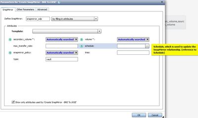

I can get the workflow to run and complete successfully, but the schedule from my original DP snapmirror is not carried over to my XDP snapmirror.  I believe the problem is that the workflow doesn't define a schedule when creating the XDP snapmirror by default, but I see that the field is available when editing the parameters.
However, just typing in the schedule name does not work.  For testing purpose, I used the schedule "hourly" which results in the following error when executing the workflow.

The error you're getting is that the command parameter for schedule:, which has the (R) in front of it, means what you must enter is a reference to a previously defined (R)eference Object in the workflow. Instead you've got a string with 'hourly'.
As mentioned you can insert a 'Search or Define' workflow step in a prior row/column somewhere before this step that setups of a Reference Object for the 'hourly' schedule but a simplier approach would be to just hit the "..." icon in the right-hand side of the schedule: input field. That pops up a 'Resource Selection' form where you can quickly tell it to find the 'hourly' schedule on that cluster as the (R)eference Object. Think of it as quickly creating an unnamed Ref-Object used just for this schedule: field. Would look something like:

I used $DestinationCluster for the "Cluster Name" field and 'hourly' for the "Schedule Name" and that worked.  I will just copy the workflow and do the same for our daily schedule snapmirrors.  I'm still not sure how the Search and Define method works but i'll have to read more about that later.
