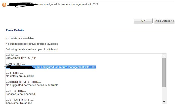

Installed it on another machine and now I seee this
TDUBB1234
6,602 Views
ok looks like I had tp enable tls on the filers
option tls.enable on
then it worked. is this not a good practice?
