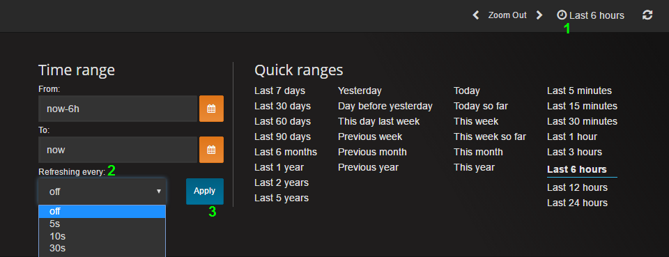

Hi @israelmmi,
To enable autorefresh just follow the 1,2,3 steps in the image below:
harvest graphite grafana enable auto refresh

israelmmi
10,588 Views
Hi,
I think you misunderstood my question. In the Netapp insight videos (you can see them on youtube) you see them adding nodes to the workload and you see the numbers changing every second. When I configured (Last 6 hours, to now, and refresh off), that doesn't do the trick.

Hi @israelmmi
By default Harvest submits data every 60s.  You could configure refresh on the dashboard to automatically show new data points, but you would only get them every 60s.  Harvest can be configured with a more frequent polling schedule.  I use this during development (data_update_freq = 10 in the Poller config) with a smaller template file so I have quick feedback but you could also do this for demos.  Take care that you also set your Graphite carbon frequency (storage-schemas.conf) to store these granular values.  In my case I have a site called 'dev' that is configured for 10s frequency in netapp-harvest.conf, use a slimmed down collection template file for that poller, updated storage-schemas.conf for the same, and then run that poller while doing dev work.
