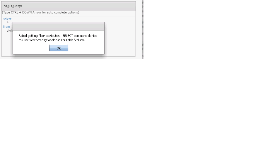

when i am trying to build a filter i am getting the error as :
Failed getting filter attributes - SELECT command denied to user 'restricted'@'localhost' for table 'volume'

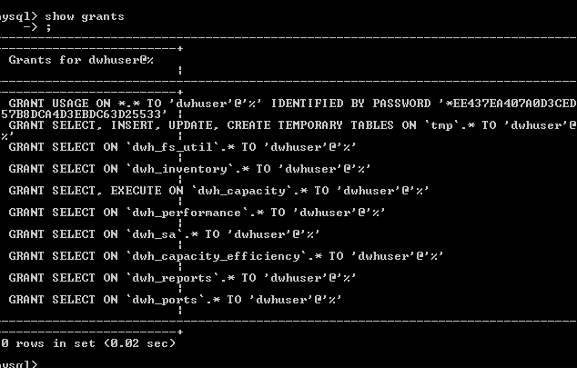

tried to grant permissions  but unable to do so, as dwhuser doesnt have permissions.

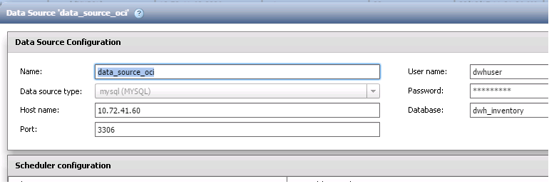

Aravind
17,283 Views
i am connecting to the dwh database through dwhuser ,not as restricted. but i dont no why it is unable to execute a select query.

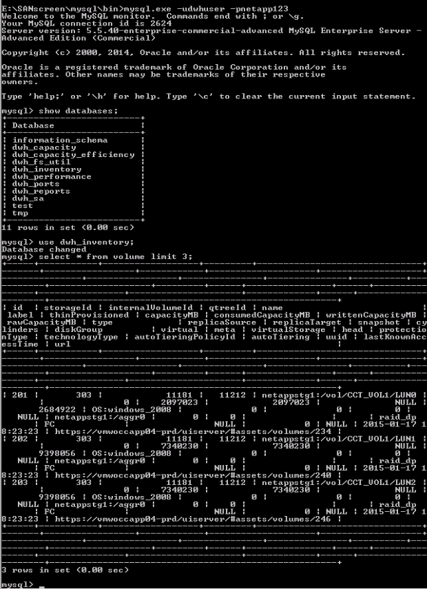

It should work. I just tested with the dwhuser and works fine for me:

from the command line and mysql client it is working fine.  but  its not working from wfa ,when  i  try   to create a filter.

Aravind
17,269 Views
i am quite confused why the username in the error is showing as  'restricted',  while  i am connecting as dwhuser.  and moreover dwhuser has  the select permissions.
and i am connecting to the db through remote sql client only. i am able to query from every possible way except from wfa.
