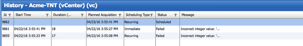

I'm trying to get vCenter 6.0 datasource setup and get this error.
NOTE: it seems the error has a <return> between the single-quotes there ... forcing it onto a 2nd line. History log looks like this:
Here is background info:
  • pretty new ESXi 6.0u2 and vCenter (the VCSA applicance running on ESXi) 6.0
  • a single datacenter: tnt-hq
  • a single ESXi host esx.tnt.com, 192.168.0.100
  • VCSA is vcsa.tnt.com, 192.168.0.101
  • 2 local datastores
  • only 2 or 3 VMs
I pulled the vCenter 6.0 datasource from store today (v1.1)
Also pulled and downloaded PowerCLI today and got latest PowerCLI 6.3 (I could try other versions if helpful)
Restarted WFA Server; setup above Execution Datasoure and got only so far. I THINK the datasoure completed because it's log file exists (in attached). Couple of errors but seemed to complete. I think this error may be from WFA trying to read in the .CSV files.
I put together a .txt'ed  zip file holding the .log and .csv. DS log file below.
Any ideas? I see some errors in log below but not sure if serious. I also see a negative number in row-1,column-1 in Lun.csv
Dave Korns

This bug got introduced in version 1.1 when another bug was fixed. It happens in cases where one of the .CSV files are empty. You see that in \WFA\jboss\standalone\tmp\wfa one of the .CSV files will be empty i.e. either you have no luns, or Nas_shares or VMs etc.
I suggest you take the version 1.3 from here. This has a been fixed to handle the above and another vCenter PowerCLI bug as well. You may read about that in the the post.
