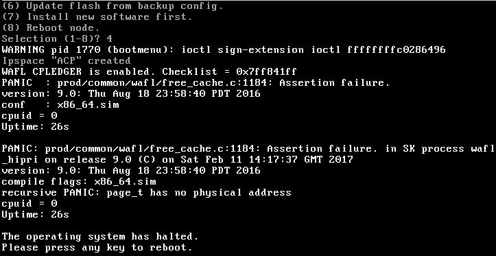

any idea how to get vsim 90 installed on virtualbox 5.1
IMHOTEPSON
10,261 Views
i tried it, but starting the wipe cdot stopped with PANIC

6gb should work, so should 3.5gb.  Its due to subtle differences in the memory map between the two virtual platforms.  If you have more, give it more.
You may find it panics again when you go to 9.1.  If so, add serial ports to the vm:
#If these are missing it can get stuck
vboxmanage modifyvm "$name" --uart1 0x3F8 4
vboxmanage modifyvm "$name" --uart2 0x2F8 3
While you're at it, the ioapic setting is often missed:
vboxmanage modifyvm "$name" --ioapic on
Then boot to the vloader and set the console variable:
setenv console vidconsole,comconsole
Then it should come up.

IMHOTEPSON
10,167 Views
done, by changing RAM Size to 6000 MB, now startup and wipe is running, let's see if this is stable solution 😉
