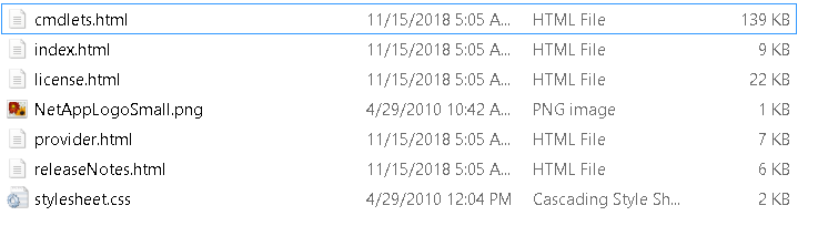

I think that I've found the cause (but not a solution, unfortunately). In older versions of the PSTK, there are several extra files that aren't contained in the latest versions of the toolkit - at least not my installation.
So when Show-NcHelp tries to copy all the help files from the module path - C:\Program Files (x86)\NetApp\NetApp Powershell Toolkit\ - to the temp directory and then launch index.html from there, it fails because index.html and the other files don't even exist in the module to begin with. I copied an index.html file from an older version to my new module and was able to launch Show-NcHelp without issue after that. The problem is that index.html references the other HTML files that don't exist, and they wouldn't be updated for 9.7 if they're copied from an older version (and obviously generate errors if clicked on).

@brandonkit The actual files are contained within the module itself and are just HTML files - my installation is located at C:\Program Files (x86)\NetApp\NetApp PowerShell Toolkit\Modules\DataONTAP\webhelp.C
Hope that helps!
