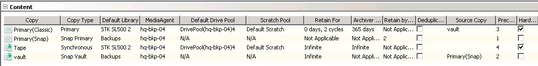

We’ll need the sendlogs
https://kb.netapp.com/support/index?page=content&id=S:1014063
And an autosupport from the primary & secondary.
If they can send a screenshot of the storage policy that will help as well. This way we can see the Data paths currently configured.

Hi deepuj, Attached is the screenshot of the storage policy.
We have already created a case:2005280944
thank you
Kangethe
11,149 Views
