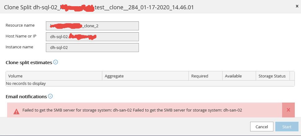

Maybe I don’t understand something, but ... Does SnapCenter 4.3 support clone splitting for SQL databases resides on LUN?
When I try to split the clone I got the following error: "Failed to get the SMB server for storage system".
Which SMB server was looking for?

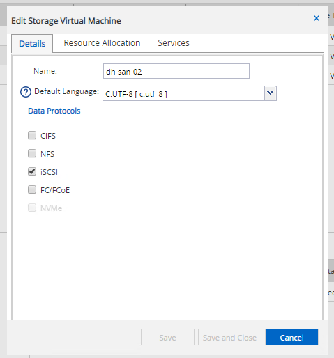

The "dh-san-02" SVM have one and only the iSCSI service. Therefore, I am very surprised why suddenly SMB:

Well, I have done the following things:
  1. Enabled CIFS services in this SMV
  2. Created same name CIFS server (dh-san-02) on this SVM
  3. Created and applied appropriate export policy
  4. Created separate network interface
  5. Created appropriate DNS records
Now, the \\dh-san-02 is available from the SnapCenter server and SQL server which hosts the SCSQL plugin.
Also, I rediscovered entire cluster in the SnapCenter and restarted SnapCenter service.
No luck (( Same error message...
Went to create the support ticket...

kkeyser1971
12,621 Views
event log show doesn't show any error at all.

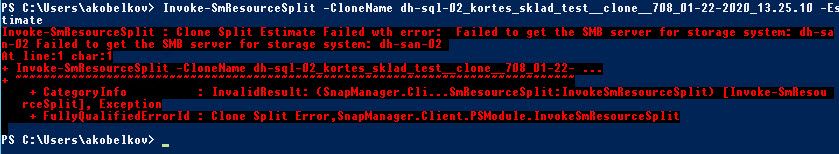

And I also noticed that the execution of the cmdlet Invoke-SmResourceSplit -Estimate gives exactly the same result:

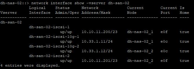

Could you give me this info:
::> network interface show -vserver <vserver> i.e dh-san-02
How is the NetApp storage (SVM) added in Snapcenter ? What IP/LIF type it is? using SVM Management IP ?
How is your setup, hows LUNs used as, datastore ?
kkeyser1971
12,581 Views
Well, dh-san-02 has four interfaces:
10.10.11.0 network - this is a 1G network. Cluster management LIF, SnapCenter server and SQL server resides in this network.
All SVM doesn't has a management LIF and doesn't managed separately in SnapCenter.
The SQL server has only one interface in the 10.10.11.0 network.

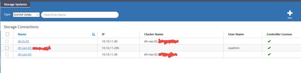

kkeyser1971
12,296 Views
Bingo! ))

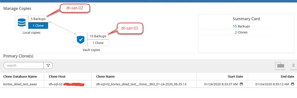

I setup to manage one of SVM indepedently:
dh-san-02 - indepedently managed, dh-san-02 - cluster managed.
Making two clone - one on dh-san-02, one on dh-san-03:2020-01-24_8-38-23.jpg

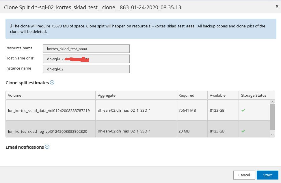

Clone Split on dh-san-02 now running without any problem:

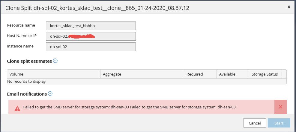

2020-01-24_8-42-53.jpgBut on dh-san-03 (cluster managed) got the same error:
We conclude that the error is due to SVM isn't managed independently.
Thank you very much for the help!
