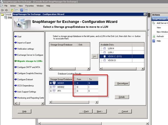

If LUNS are all there SHOULD we make the MDB's DIRECT on the STORAGE. This realted to ECMP1649948.pdf page 19. Evene if we have to RUN the Migration wizard then.
CAN this be the identical PATH in the FIELD FROM and TO in below screenshots then?

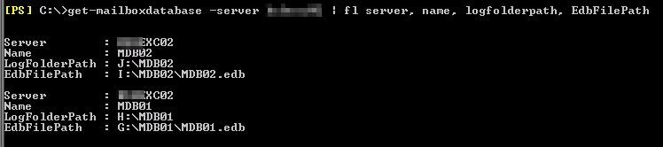

This shows how we did old the two FIRST NODES before ANY Productive Data was on the Exchange a few years ago.
Both MDB and the LOCAL database + TS LOGS where first PUT on the 😧 Drives of both DAG than migrated to the LUN with SME.
I can't do that with a NEW add node. Because the PATHS will be different TO the running existing setup....
Way we setup the FIRST TWO NODES
Existing DBS's and paths FINALL version with 2 NODES
