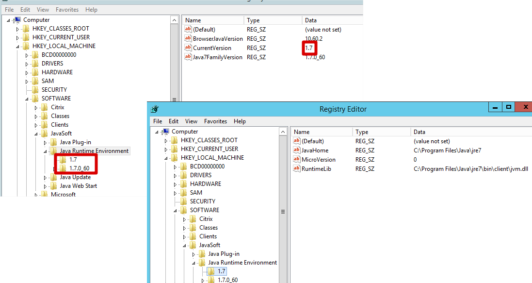

Java JRE 1.7 is installed ont he computer.
I saw on registry :
HKEY_LOCAL_MACHINE\SOFTWARE\JavaSoft\Java Runtime Environment\Current Version > REG_SZ  >  1.7
Could you please help me. I found any solution or post about this issue.

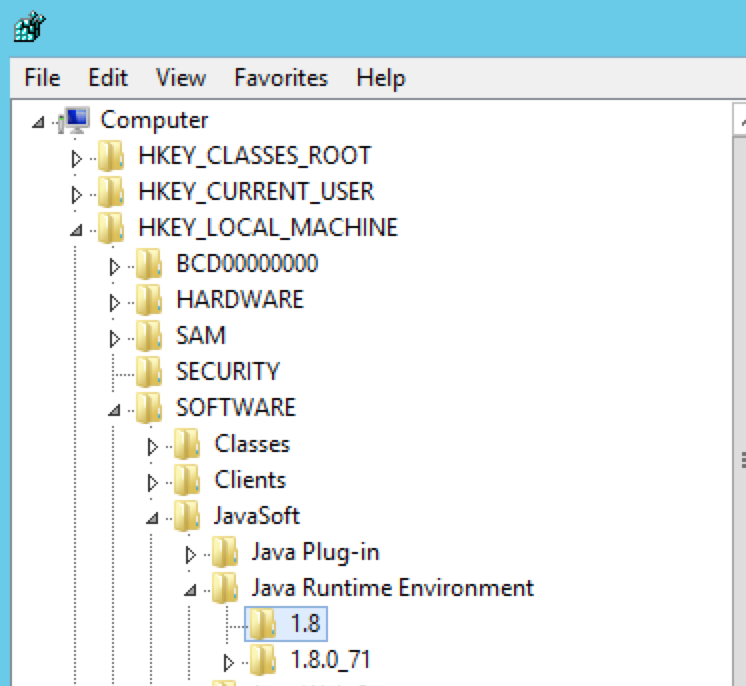

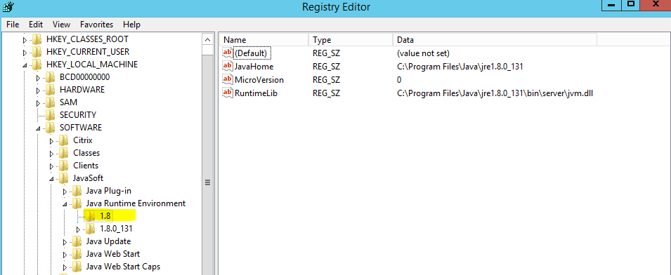

nishant10
30,230 Views
The registry entry we are looking for is: HKEY_LOCAL_MACHINE\SOFTWARE\JavaSoft\Java Runtime Environment\1.8
Please share your OS version.
Nishant
tkpf
30,169 Views
Hi,
The server I want to deploy the MySQL plugin is "Windows Server 2012 R2 x64".
The requested Java version is 1.7 or later ("SWInstallerHelper GetJavaVersion: Error: Java(JRE) 1.7 or higher needs to be installed on this machine.")
See below the registry of the destination server :
I alson tried with the last version of JRE8.
The error is the the same, but with JRE 1.8.

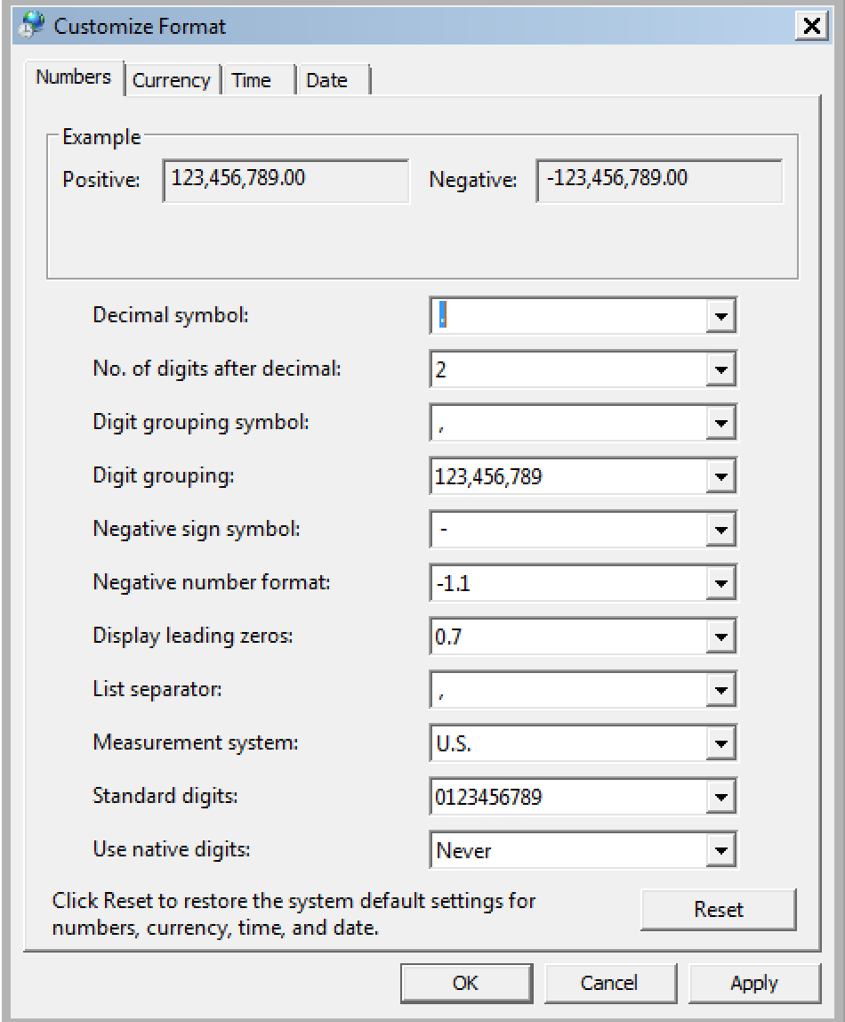

We debugged and looks like the issue is an error happening while parsing the java version("1.8").
One possible reason for that can be that decimal separator on your machine can be other then a dot (.), so can you verify the decimal seprator in your system and let us know what it is. Here are the steps to find it out.
- Open "start menu" and start typing regional.
- Select Change date, time or number formats.
- Go to additional settings.
- Under the numbers tab.
- The decimal separator value.
If in case the decimal separator is not dot (.), can you change it to dot(.) and try out the installation again.
tkpf
30,070 Views
Hi,
I checked the parameters, indeed "," was defined. I changed to "."
Nothing changed, I have the same error.
I also tried with English language instead of French, same issue.

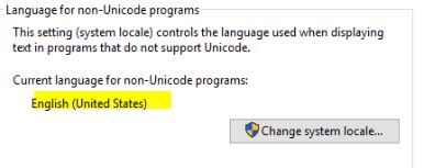

matte
29,690 Views
What do you mean with " i changed the system language"?
are you talking about the Format language or the locale settings?
please confirm that you have English as locale..
tkpf
29,661 Views
Hi,
As you asked, I also changed "System locale language", I didn't changed last time ;(
I changed from "French (France)" to "English (Unites States)".
The problem is still the same, I rebooted the server too.
