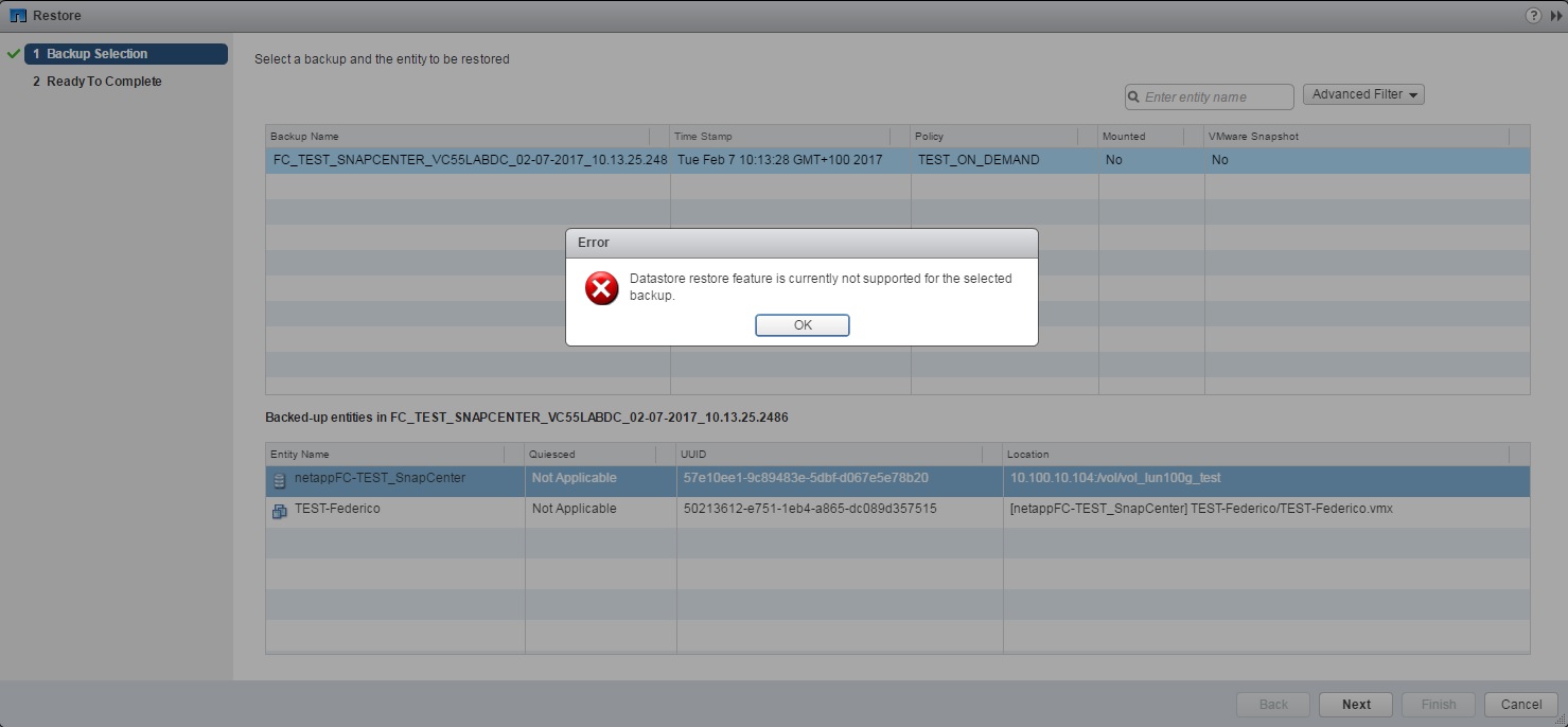

does someone know if it's possible to restore entire nfs datastore from a vsc+snapcenter backup job?
If I try to restore a datastore the vsc wizard says "datastore restore feature is currently not supported for the selected backup" while I can restore a datastore from a vsc only backup job.

Hi Hariprak
I have read the documentation so I try to restore a datastore NFS or FC (this printscreen) but as you can see the wizard stops immediately with this error:
this backup is on the primary storage (no snapvault / snapmirror)
If the same datastore was backed up with a legacy VSC job (no Snapcenter integration) I can restore the datastore!
Regards
