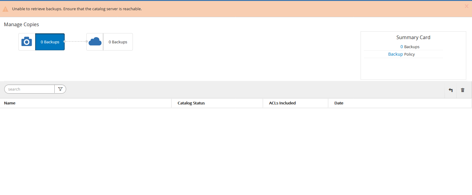

Dear Community,
When I start a BackupJob in the Snapcenter, the job takes infinite. I checked the NetApp-Filers, there are creating Snapshots.
"Unable to retrieve backups. Ensure that the catalog server is reachable."
I restarted the Services on the Linux, maybe anyone else has an Idea?
Best Regards
Fabian

I think he has a Problem with the sc.sh Script:
 ./sc.sh
Thu Aug 31 11:50:09 UTC 2017 - root --- Action type :-
./sc.sh: line 235: [: =: unary operator expected
./sc.sh: line 267: [: =: unary operator expected
./sc.sh: line 273: [: =: unary operator expected
Thu Aug 31 11:50:09 UTC 2017 - root --- Simply Sleeping for 36s
Thu Aug 31 11:50:45 UTC 2017 - root --- Completed executing shell script
SFXCA: Failed to unload app domain. Error code 0x80131015
Action ended 14:19:30: UpgradeAction. Return value 1.
Action ended 14:19:30: INSTALL. Return value 1.

SnapCenter is expecting the root user to be using the bash shell.  What shell is your root user using?
Fabian1993
4,588 Views
The Root  User is using the Bash.
If i try to start the Indexservice is get these Error:
Waiting up to 30 seconds to see Solr running on port 8983 [-]  Still not seeing Solr listening on 8983 after 30 seconds!
2017-09-18 12:07:13.469 WARN  (main-SendThread(172.16.77.35:2181)) [   ] o.a.z.ClientCnxn Session 0x0 for server null, unexpected error, closing socket connection and attempting reconnect
