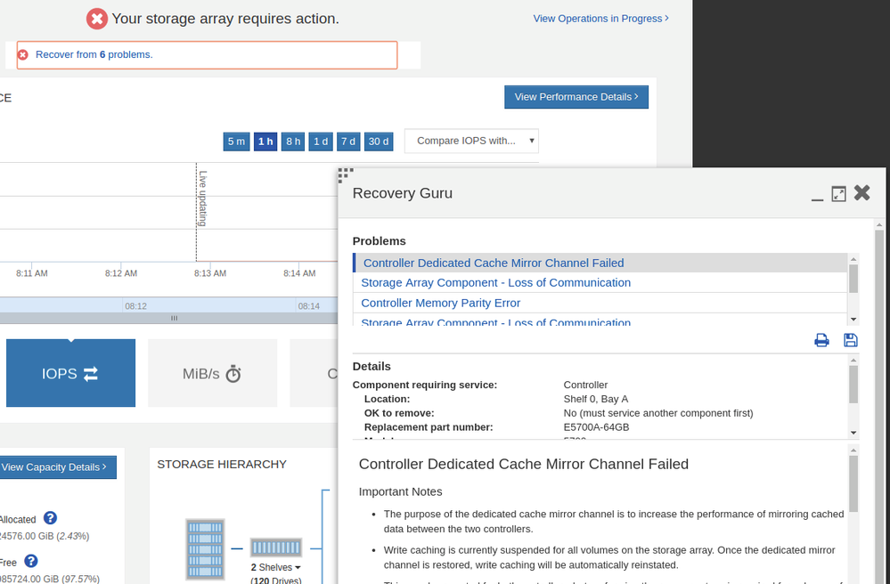

We have had a message appear "Volume Not On Preferred Path".  The diagnostic message says the following:
Are any Host Redundancy Lost problems being reported in the Problems area?
Where is this "Problems area"?  There is no reference to it in any GUI element that I can see and searching for it in the documentation yields no results?

hey @__mattb__
Usually when there is a critical failure you will get a notification in the main page, saying your storage array requires attention, and if you click there it will pop - up the recovery guru, which has the problems area were you'll get details about the ongoing issues affecting your array.
I have one broken array at the time, so i can gladly share this screenshot with you 🙂
