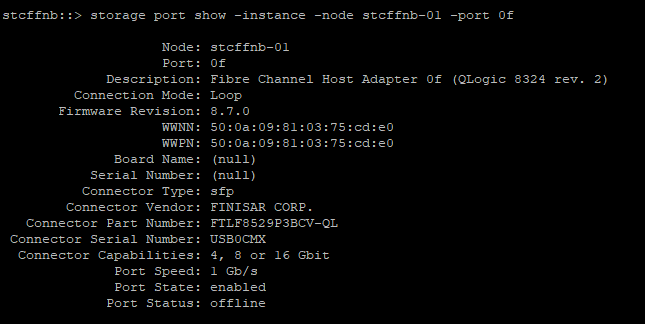

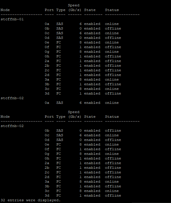

We're currently experiencing a bit of trouble getting ports 0f & 3b online on both heads
We believe the issue might have to do with the SFP

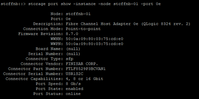

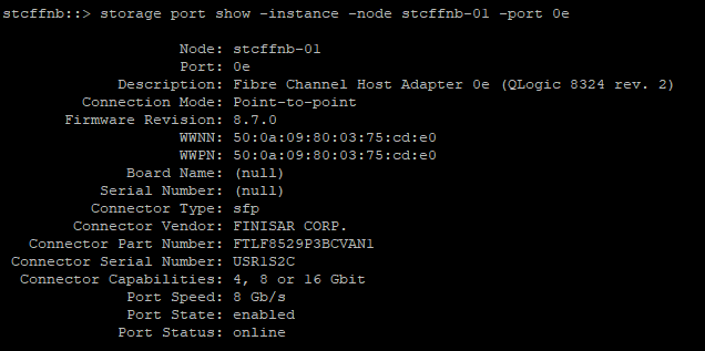

The SFP 0f is stuck in Connection Mode: Loop for whatever reason
By comparison:
0e appears to be working. We suspect due to having a Connection Mode: Point-to-Point

You have the same behavior on 4 ports? 0f and 3b on each controller? That is strange... I would not blame it on the transceiver.
0f shows port speed as 1Gbps which is not supported by this transceiver (4/8/16). Did you check port speed set on the switches?
