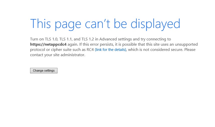

Can you access the webfrontend by browser over https ?
Does it produce a warning ?
I got the below error:-
I have checked TLS1.1 and TLS 1.2 and both are enabled.

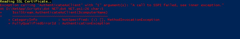

As for the code in the link provided, I got the below error:
However, in the test lab both tests works fine.
