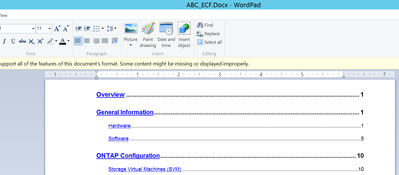

That exact command worked for me on my ONTAP 9.8 system:
PS C:\Users\Administrator> Get-NtapClusterData -Name x.x.x.x -Credential admin| Format-NtapClusterData | Out-NtapDocument -WordFile 'C:\ABC_ECF.Docx' -ExcelFile 'C:\ABC_ECF.xlsx'
WARNING: The following document parameters were not specified: CustomerName, CustomerLocation, ProjectName, AuthorName. See the relevant FAQ entry in the help pages for more information on how to manually update the cover pages of the output document(s).
