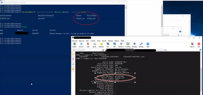

After upgrade Ontap to 9.11.1P3 powershell 9.11.1.2208 cmdlet Get-NcSnapmirror return different out.
Look at  the output off the cmdlet column  Status it show "broken_off" instead of "idle", that is the output show by the cli.
It seems to be a bug.  Do you know is there are a new version of powershell with a fix for it?

Thank. I have alredy get the solution
Use ONTAPIs instead of REST APIs by
Connect-NcController ControllerIP -ONTAPI

Thank you for your input. Solved my issue as well. A bit distressing that the zapi to rest conversion runs seemingly without any QA
