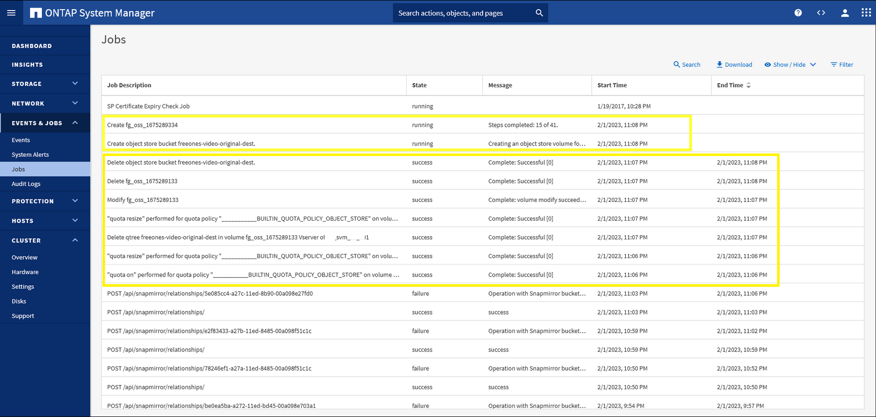

Hello,
I have big problems with setting up snapmirror for buckets. I did spend a huge amount of time on this and it is still not working. I am pretty sure that I followed all steps and that all certificates are right now. In the jobs log overview I even see the bucket being created and after a while deleted again:
I also tried to do bucket snapmirrors within the same cluster, so no intercluster, but even there it doesn't want to work.
Running Version 9.11.1RC1 on all clusters.
I can't wait to hear the solution after spending all these hours on this issue ;(
thank you
Maurice

snapmirror-bucket2.pngI got the licenses right after quite some time and thought it would work after that. However it is still not working. Error message:
Operation with Snapmirror bucket relationship failed. Reason: Connection unavailable
I have disabled http (443) on both S3 SVM's so it can't be a certificate problem.
Anybody who can finally help me out?
thank you
Maurice
