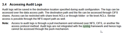

Correct. CIFS audit logs cannot be pushed to another server, only accessed through a CIFS share.
Reference from documentation:
https://www.netapp.com/pdf.html?item=/media/16330-tr-4189pdf.pdf
Pg. 12
Pg. 12
