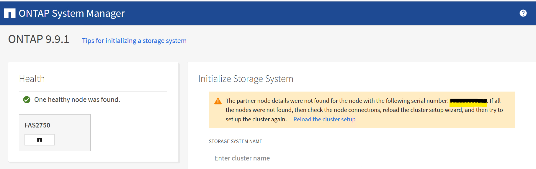

Hello Team,
Installing Fas2750 2-node cluster, after assigning the ips to both node and trying to build cluster from first node UI but its not discovering the other node its only showing 1-node.
Please let me know how to resolve this issue.

Please open a case. I suspect there could be a HW issue, but I'm not sure and this requires more troubleshooting.
Perhaps reseating the controllers in the chassis might be in order?

I agree with @paulc, have you tried reseating the node? leave it out around 1 m o 2 , then put it back again, nd boot it
