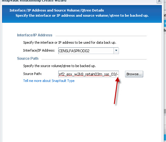

I am planning on using OCUM. I have created the snapvault jobs from here as well and plan to create flexclone of the volume as a way to restore to an earlier snapvault initiated snapshot.
I thought you didnt need qtrees for flexvolumes whch are just used as data luns? there is an option to create a none qtree snapvault. I have had to create a qtree on the destination end which isnt an issue.
