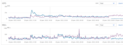

The excess load was my first guess but as you can see from the graphics below, we don't observer something exceptional at the time when Node usage climbs to 100%
Thank you for the links. We are definitely determined to upgrade to ONTAP 9.8, just on hold at the moment waiting the support to be renewed. Don't want to risk un upgrade in case of any unpredictable behaviour by the disk array.
