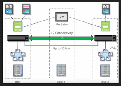

@borkp  I am not sure whey NetApp changed the image for ONTAP Select MetroCluster SDS on the documentation here https://docs.netapp.com/us-en/ontap-select/concept_usecase_mc_sds.html
The Image below or here"https://www.netapp.com/media/main-DR3_tcm19-39080.png" show L2 connectivity between sites.
To answer your questions:
a. Yes your understanding of a 2-node HA deployment is correct, each site needs locally survivable hardware (hosts+datastores).  Don't forget the mediator at the third site (site#3).
b. Yes, you are correct L2 typologies are the limitation, it also limits the distance between sites due to the 5ms RTT + 5ms Jitter requirements (5ms RTT with a maximum jitter of up to 5ms, for a total of 10ms maximum.latency).
