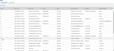

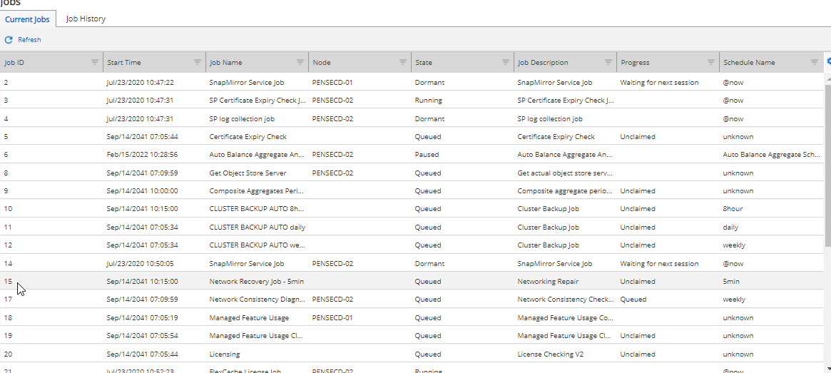

However in the job view, we noticed many standards jobs are dated into future year 2041, unclaimed with queued status.
Some of it with schedule unknown.
We tried to change the schedule name that is known with different time 5mins.. we change it run every 6 mins. However the job did not run. How could we get the standard jobs to run again with the right queued or start date?
We also tried job unclaim, resume and etc command however nothing works.
Any ideas?
