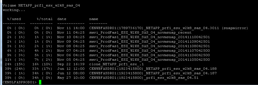

I been looking at the snapshots on volumes on the source filer and appear to see some odd things:
We currently use VSC for VMware to perform snapmirror updates on a retenion of 7 days, these are shown as smvi_****** which are fine.
We also have a snapmirror job which runs every few hours which is also shown right on the top line.
What I dont get is the snapshots going back to June/May. Are these safe to delete? or is one of these like a baseline snapshot which the other snapshots are dependent on?
I am thinking if these are not required, these snapshots are quite large in size and could be the reason why the space is being taken on the aggregate.
